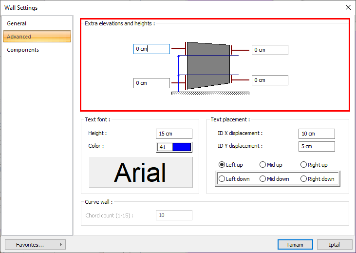

You can access the corner point elevation feature from the Advanced tab of the Wall Settings dialog .
  • Enter the settings of the wall you want to change the corner point of elevations.
  • Set values ​​for the corner elevations in the advanced settings tab.
  • Your wall will be updated according to the corner elevations you entered.

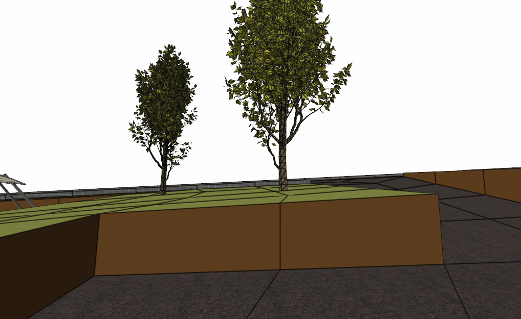

Area to create a garden wall

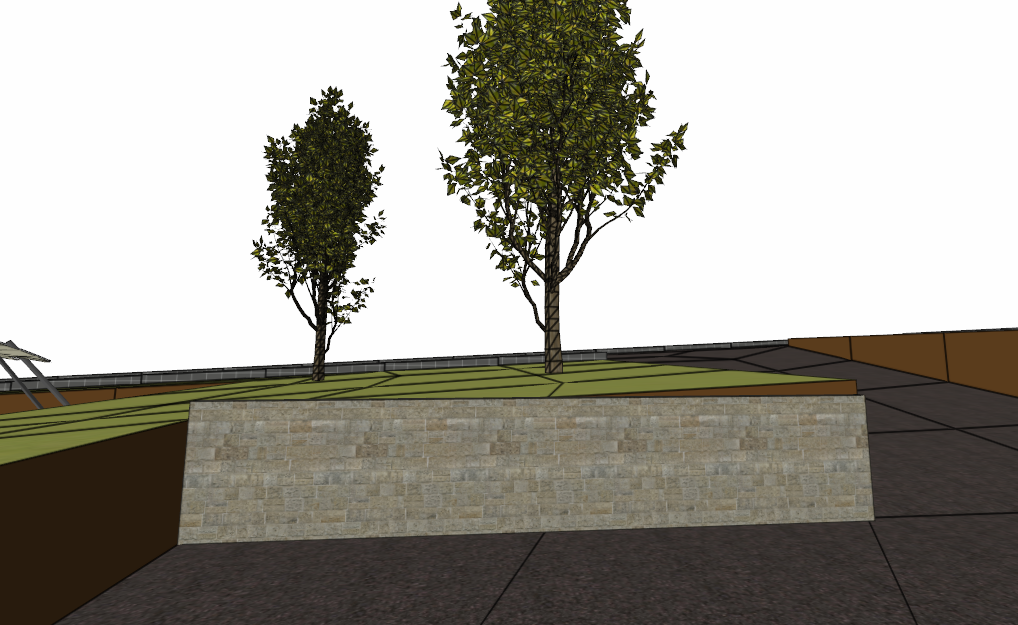

Before the walls are leveled at the corner points

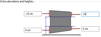

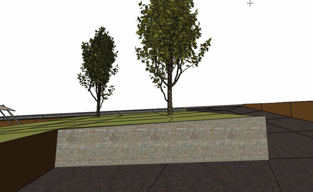

Entering the value -15 on the upper left corner of the wall
Giving +15 value at the upper right corner of the wall
