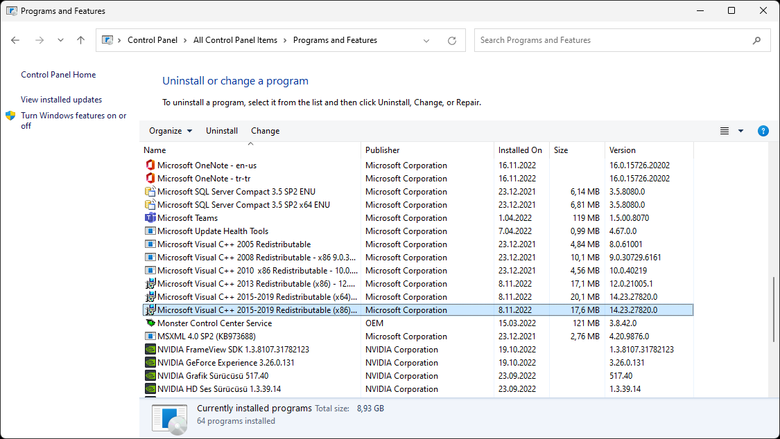

  • Enter the control panel. Check if the "Microsoft Visual C ++ 2015-2019 Redistributable (* 86)" add-on is installed in the Programs and Features section.

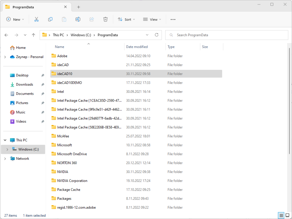

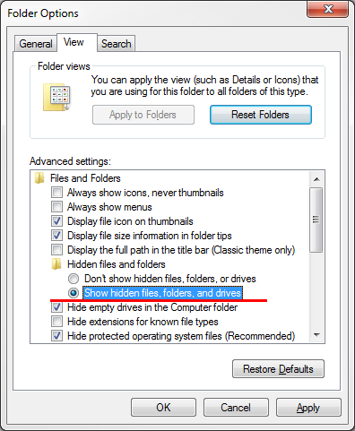

  • If you can't see the ProgramData folder, it may be in hidden location. You can make it visible by checking the "Show hidden files and folders" option in the "Folder and Search options" section.

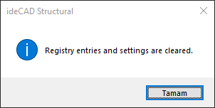

  • Do not release the Ctrl and Shift keys until the message "Registry entries and settings are cleared" appears on the screen.
  • The warning may remain in the background.
  • Click OK on the warning.
