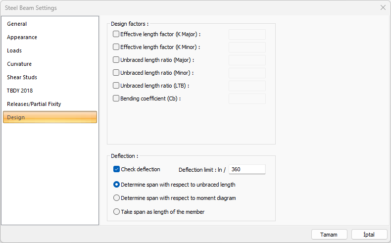

Deflection check for steel elements is carried out under gravity loads such as dead loads, live loads, and snow loads, depending on user control by CYTHYE 2016 (GKT & YDKT), AISC 360-16 (ASD & LRFD) or EN 1993-1-1 codes.
Solution:
  • Steel element cross-section can be enlarged.
  • It can be determined by checking the steel element deflection limit according to the given steel design codes.
