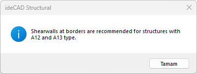

If edge shearwalls are not present in shearwall-only systems (A12, A13), a warning related to clause 4.2.3.4(b) is displayed on the analysis window.
