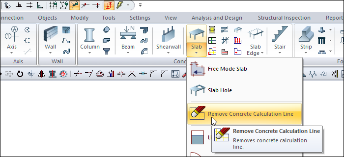

Location of Remove Concrete Calculation Line Command
You can reach it under the Concrete tab in the ribbon menu under the Concrete heading.
  • Click the remove concrete calculation line icon.
  • Move your mouse over the concrete calculation line you want to delete and click with the left button.
  • Concrete calculation line will be deleted.

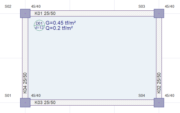

Slab before the concrete calculation line is removed

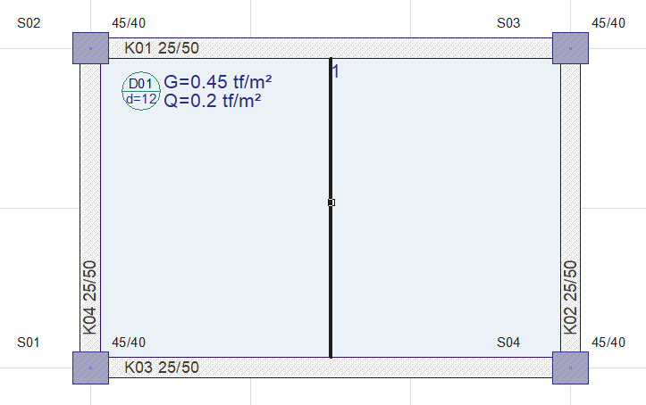

Selecting the concrete calculation line to be deleted
Slab after the concrete calculation line is removed
