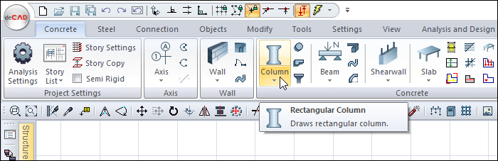

  • Click the column icon from the ribbon menu . The column command will be activated.

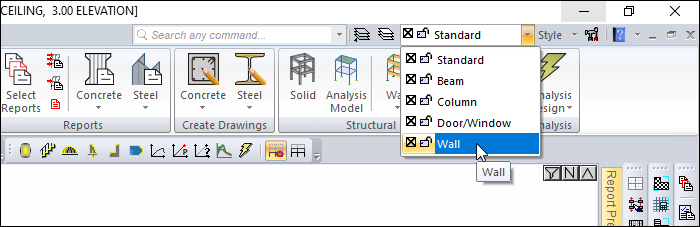

  • Open the layer list in the upper right corner of the program, select the wall layer from here .
  • After that, your column objects will be defined in the wall layer.
With this method, you can create objects in any layer you want.
