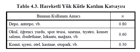

4.5.9.2 - The singular mass m ( j S) acting on the typical finite element joint j will be calculated by Equation (4.16) .
Here w G, j (S) and w Q, j (S) denote the resultant constant load and live load acting on the finite element node j. Eq. (4.16) , located in the movable load mass participation coefficient , n , Table 4.3 'are given. In industrial buildings, n = 1 will be taken for fixed equipment weights , but crane lifting loads will not be taken into account in the floor weights. 30% of snow loads will be taken into account in calculating the weight of the roof. The condition given in 6.1.3 regarding non-structural elements and fittings shall be taken into account.
