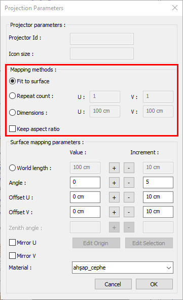

You can access the mapping methods from the projection parameters dialog.
Fit to surface
Places the texture to cover the selected surfaces.
Repeat count
Repeats the texture for the values ​​entered on the selected surfaces.
Dimensions
Texture length is determined by entering values ​​in two directions.
Keep aspect ratio
If checked, the texture is edited by entering a value in the U box from the number of repetitions and dimensions lines.

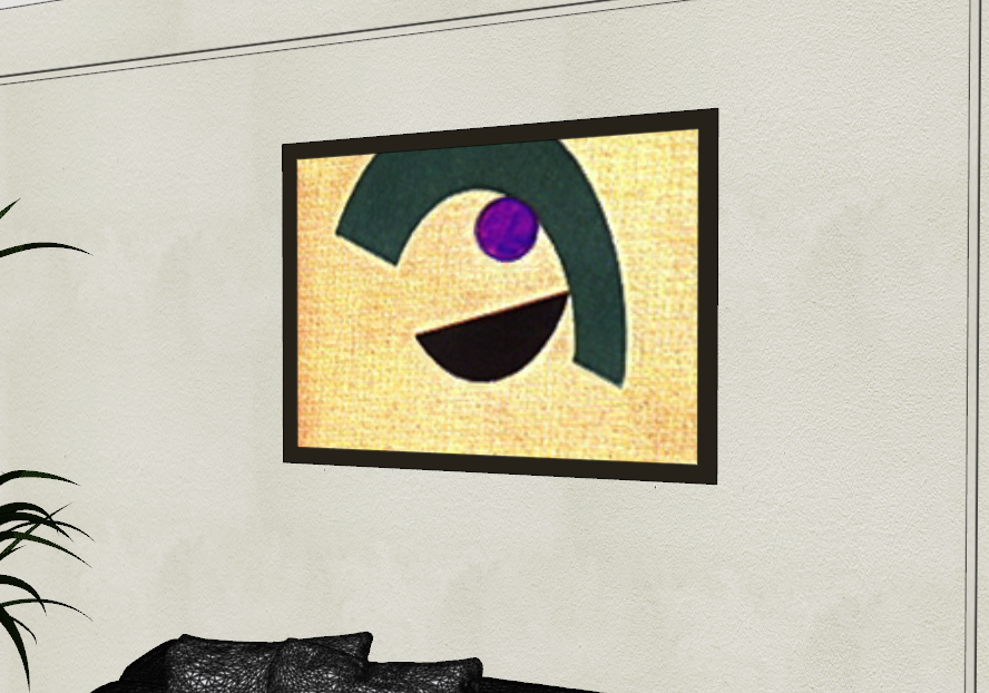

Before applying the mapping method
When the fit to surface method is checked

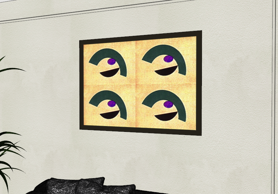

When the repeat count method is checked - U:2 V:2

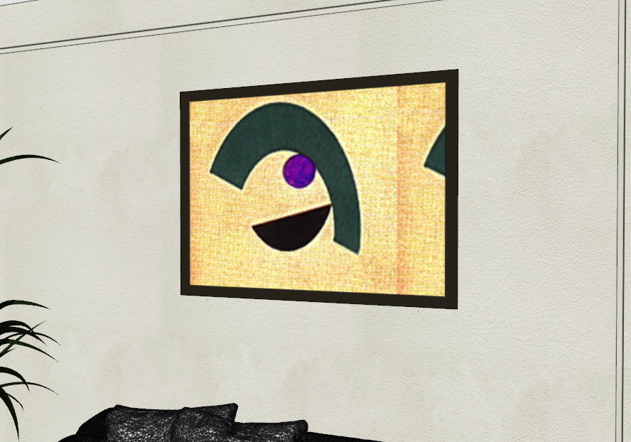

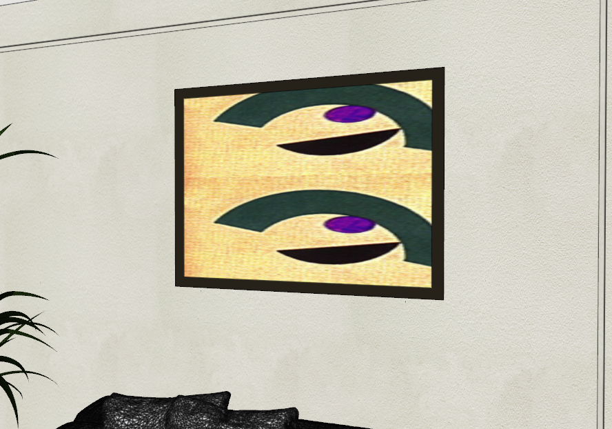

When the dimensions method is checked - L:150 V:50

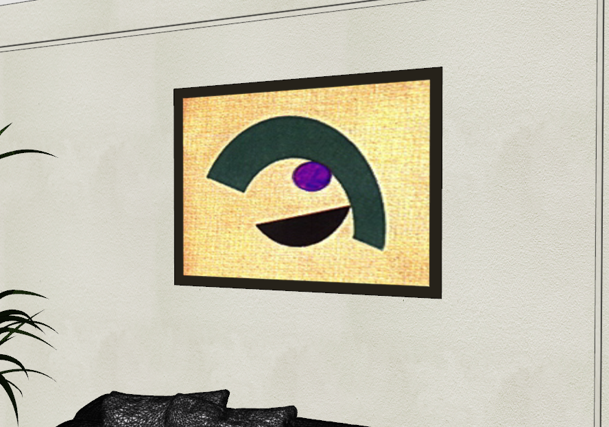

When keep aspectsratio and fit to surface methods are checked
