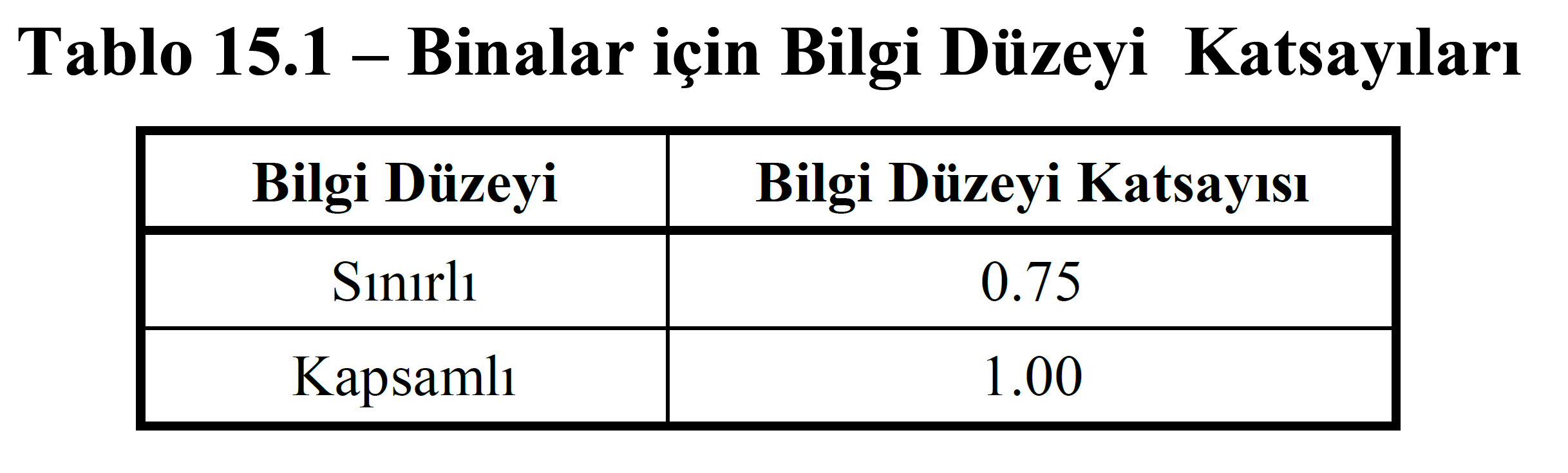

The selection of information level in the carrier systems of existing buildings is classified as Limited or Comprehensive with on-site measurements . The selected knowledge level and the knowledge level coefficient specified in TBDY Table 15.1 are used when defining the material model of concrete and reinforcement. In this way, the knowledge level coefficients are reflected in the calculation methods (linear earthquake calculation and nonlinear earthquake calculation).
