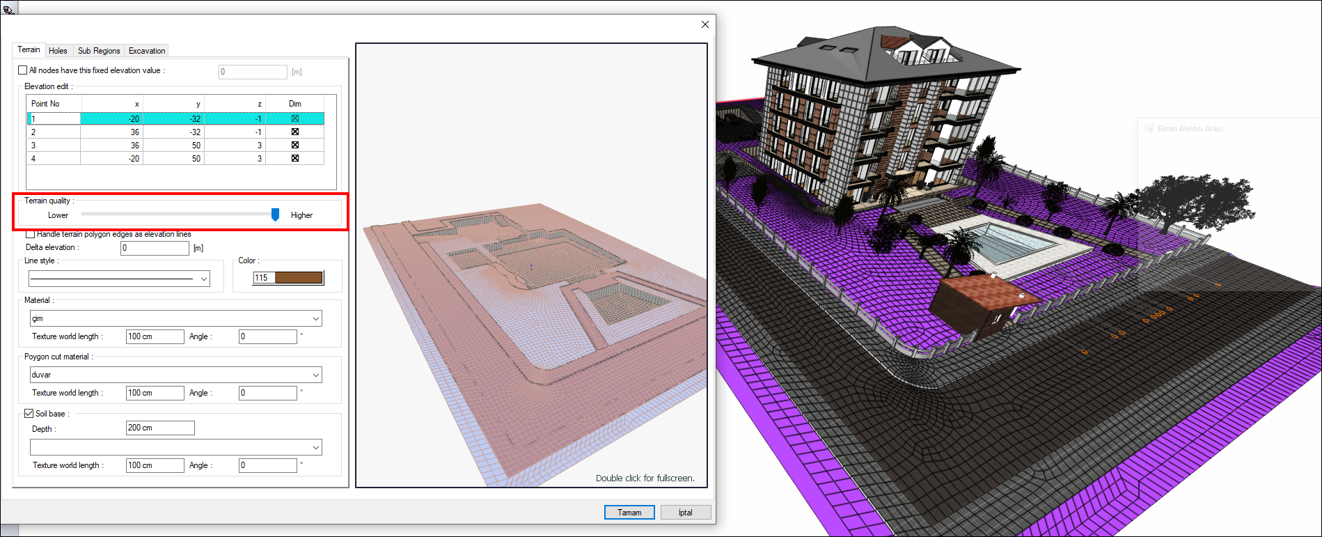

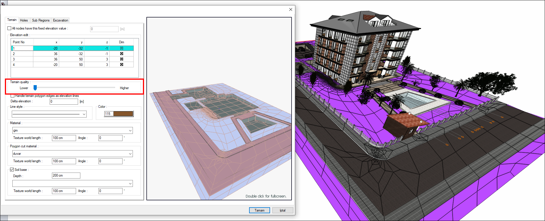

Terrain Quality
The detail level of the terrain is determined with the "Terrain Quality" option in the terrain settings.
With the pointer drawn from left to right, the detail lines seen on the terrain increase. The pointer should be adjusted to a level that will give the optimum performance according to the hardware power of your computer.
