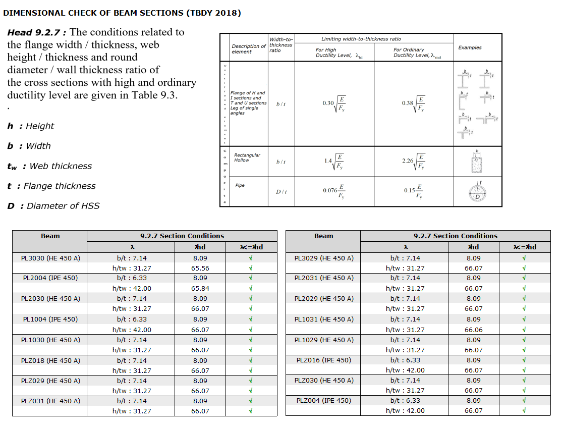

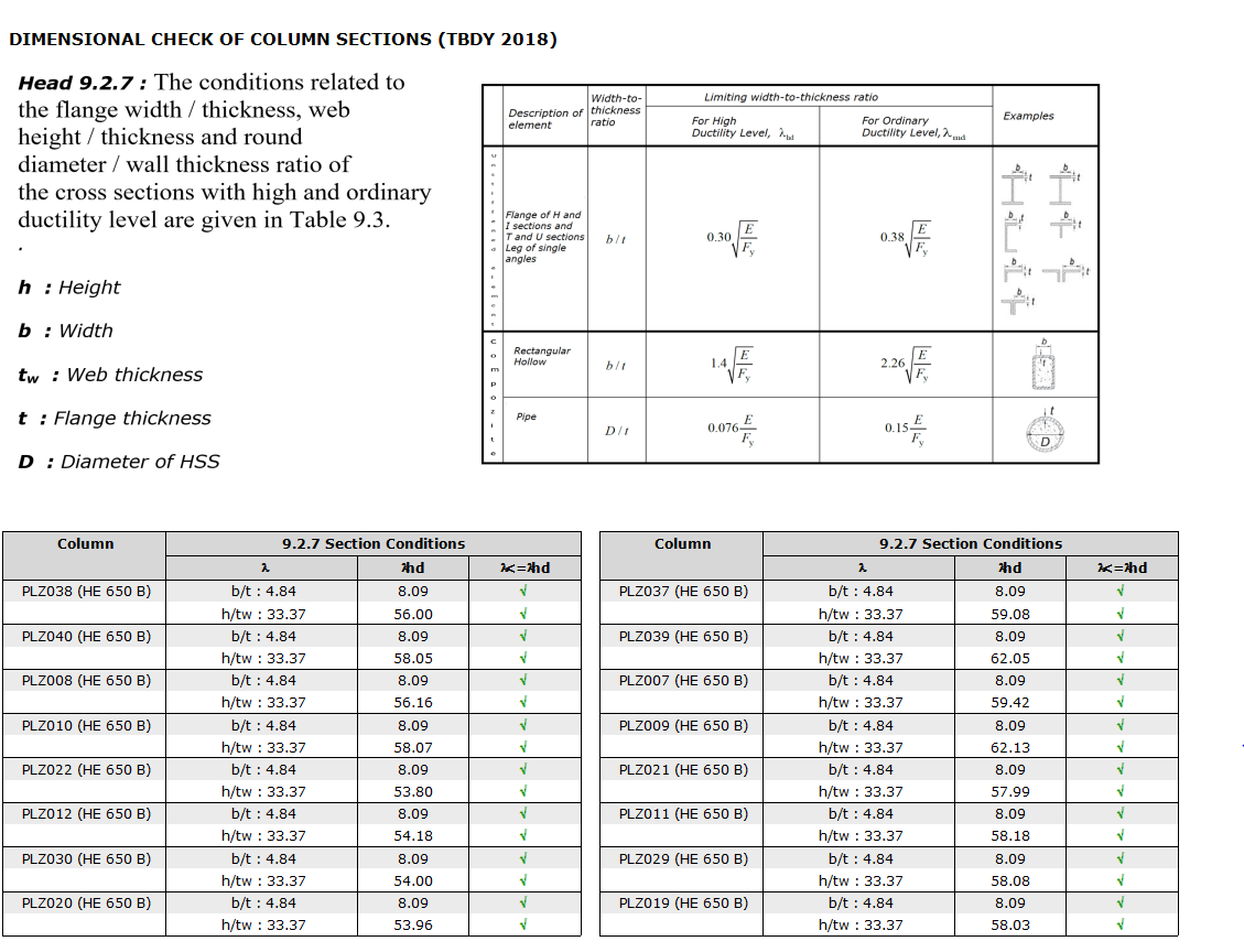

9.3.1.1 Width-to-Thickness Ratios Report
Steel columns, beams and braces defined as the moment-resisting frame and concentrically braced frame element can be viewed in the control reports.
  • Cross-sections of steel columns and beams, which are frame members with high ductility level, are checked according to Table 9.3 and are included in the relevant reports.
