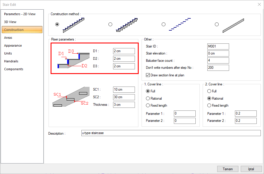

Stair coating thicknesses are adjusted by entering a value. The entered values ​​are reflected in both the plan drawing and the 3D model of the stair.
Location of Stair Coating Thickness Settings
You can access the coating thickness settings from the construction tab in the stair settings or stair edit dialogs.
Step coating nose length
The nose length of the step coating is entered. If the nose is not desired, 0 is entered.
Riser coating thickness
The thickness of the riser coating is entered. If coating is not desired, these values ​​are entered as zero.
Step coating thickness
It is the step coating thickness. If coating is not desired, these values ​​are entered as zero.

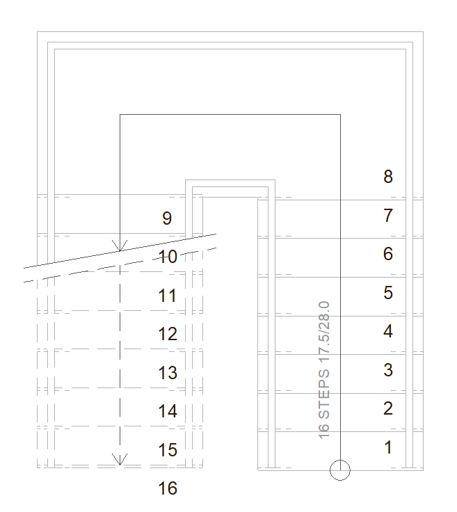

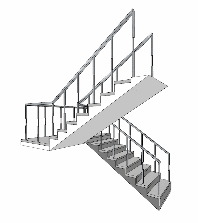

Example Stairs with Different Coating Thickness

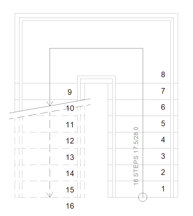

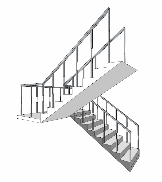

When D1, D2 and D3 are 0
When D1, D2 and D3 are 2 cm

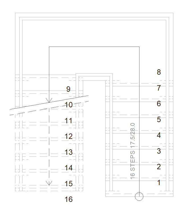

When D1, D2 and D3 are 5
