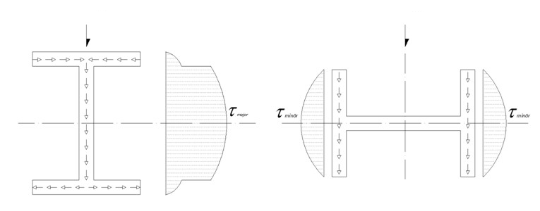

In design per share, it is assumed that shear force is completely carried by the web, no interaction between bending and shear occurs, yield stress in shear is,
