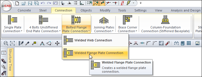

Location of the Welded Flange Plate Connection Command
You can access it under the Ribbon menu, Connection tab, Connection title.
If Draw in Fast Mode is Active
  • From the Connection menu, click the Welded Flange Plate Connection icon.
  • In 3D perspective view, move the mouse pointer closer to the element, close to the support
  • After this process, the virtual image of the connection will appear.
  • If the connection is suitable, create the connection by clicking the left mouse button.
  • The connection will occur with default settings.

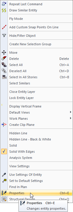

If the draw in fast mode is inactive, select the connection and click the right mouse button. Click the Properties line from the right click menu that opens.

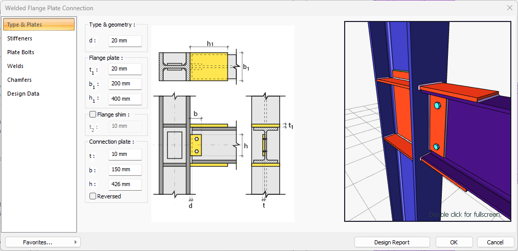

Type and Plates Tab

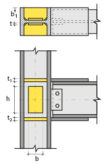

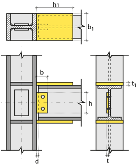

Type and geometry
The distance between column head and beam section is entered. The values ​​to be entered are shown in the schematic drawing.
Flange plate
Flange plate is determined by entering values. The values ​​to be entered are shown in the schematic drawing.
Flange shim
Shim is a plate placed between the elements to be connected in bolted connections. If shim is to be made, the option is selected and t2, thickness value is given.
Connection plate
Connection plate is determined by entering values. The values ​​to be entered are shown in the schematic drawing.
Schematic drawing
Connection and plate values ​​are shown on the schematic drawing.

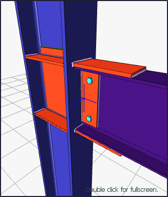

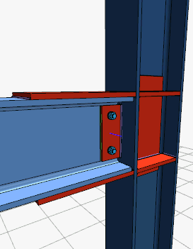

Preview
There is a preview of the connection. The selection made and the entered values ​​can be followed simultaneously in the preview.

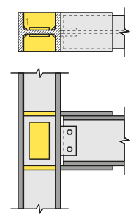

Stiffeners Tab
Continuity plate
The purpose of the continuity plates is to support the column heads in the column-beam joints and to ensure the continuity of the beam head. Continuity plates are used for reinforcement in order to bend the column head and prevent column stem flow / wrinkle. If a continuity plate will be made, the option is marked. Continuity plate is determined by entering values. The values ​​to be entered are shown in the schematic drawing.
Web doubler plate
If the column body thickness is insufficient, web doubler plates are used to meet the shear effect of the panel area. If the webdoubler plate will be made, the option is marked. Web doubler plate is determined by entering values. The values ​​to be entered are shown in the schematic drawing.
Schematic drawing

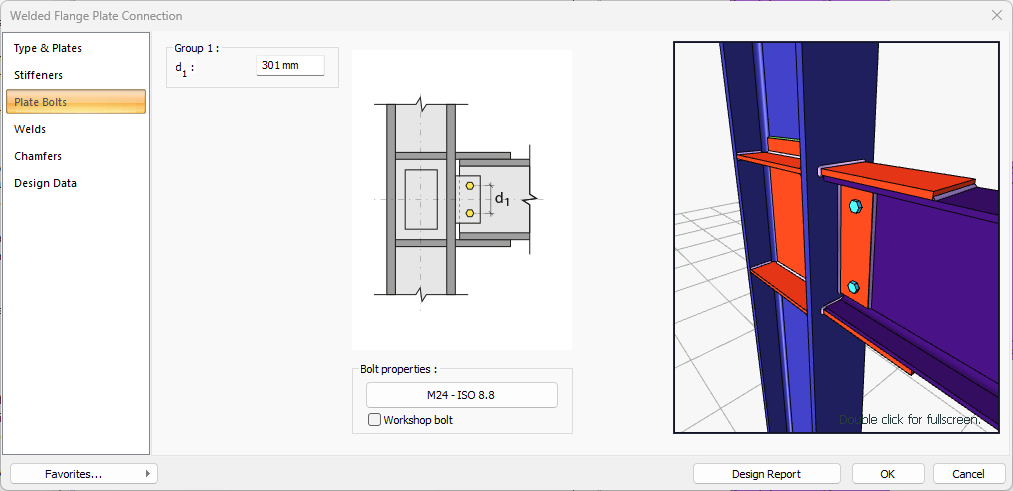

Plate Bolts Tab
Group 1
Bolt distance values ​​are entered. The values ​​to be entered are shown in the schematic drawing.
Bolt properties
The Hole and Bolt Parameters dialog is opened by clicking on the bolt properties button. The bolt properties are set in this dialog.
Schematic drawing
Connection and bolt placement values ​​are shown on the schematic drawing.
Preview

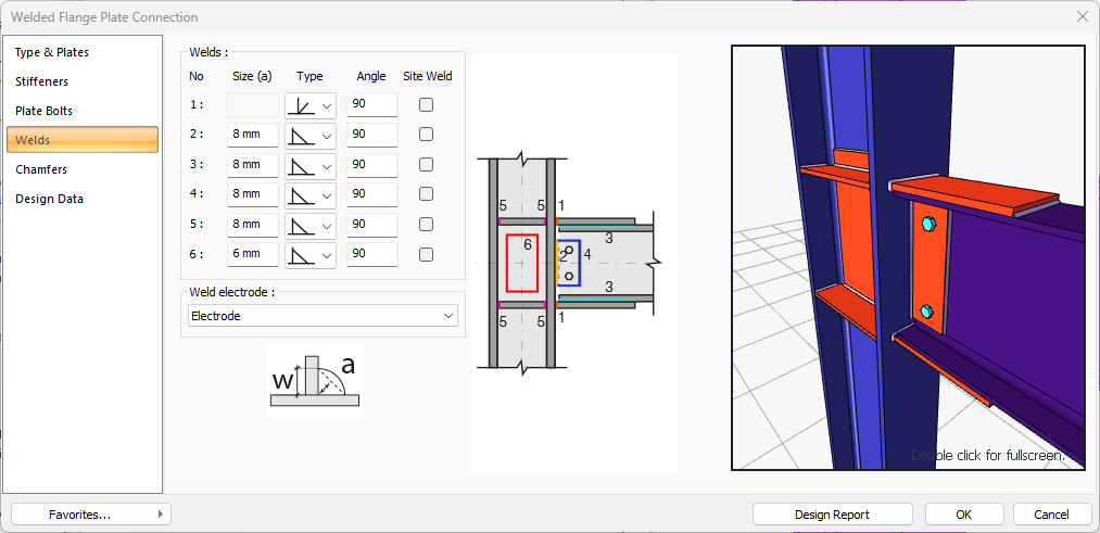

Welds Tab
Welds
The thickness, type and angle values ​​of the welds to be made at the connections are given. The information on whether it will be done on the construction site or not is entered.
Weld electrode
The strengths of the welding electrodes are defined in the design inputs. The strength of the main element in the weld joint is controlled under the condition that it has less strength than the weld strength.
If necessary, click the list and define "Create New…". To create the welding electrode, give the information "Name" and "Weld metal tensile strength" in the dialog that opens after clicking "Create New".
Welding geometry is determined automatically by the program. These properties can be changed to easily determine the connection properties. Geometry features are in accordance with industry standards and in the form specified in AISC.

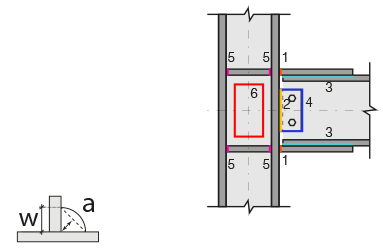

Schematic drawing
Connection and weld values ​​are shown on the schematic drawing.

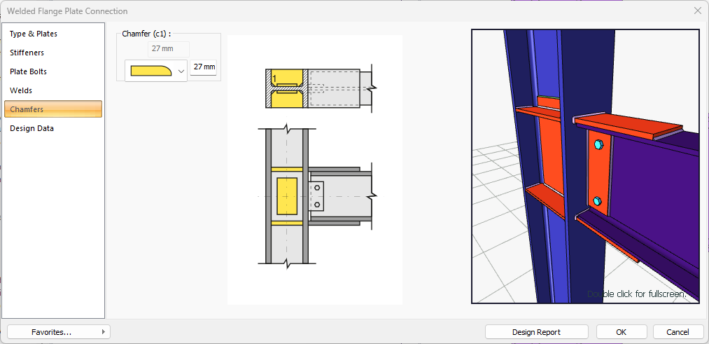

Chamfers Tab
Chamfer (c1)
For easy assembly of the plates in the field, the use of slope, slope type and geometric properties are determined by entering the value.
Schematic drawing
Connection, notching and cutting values ​​are shown on the schematic drawing.
Preview

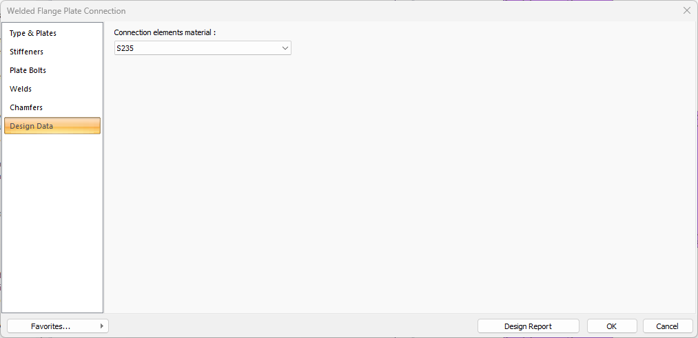

Design Data Tab
In the design data, the connection elements material is defined. The condition that the main element in the weld joint has less strength than the weld strength is controlled.
If necessary, click the list and define "Create New…". To create the connection elements material, give the information material definitions and values in the dialog that opens after clicking "Create New".
