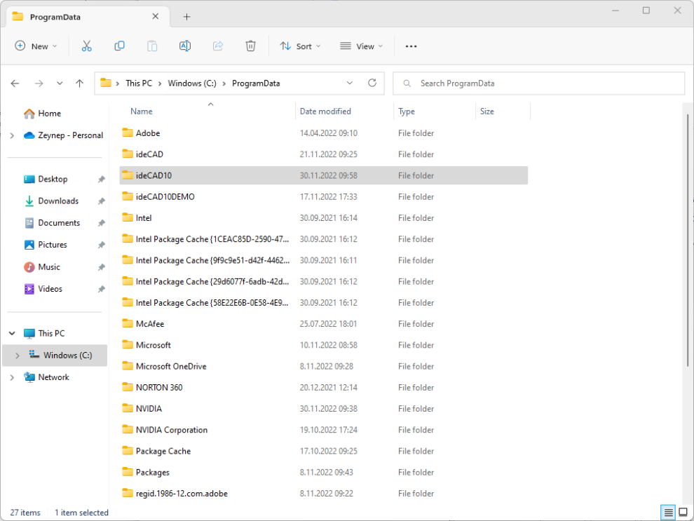

  • Delete the C:\ProgramData\ideCAD10 folder.

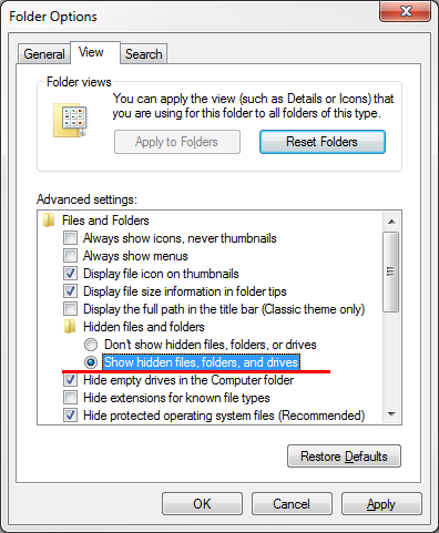

  • If you can't see the ProgramData folder, it may be in a hidden location. You can make it visible by checking the "Show hidden files, folders and drives" option in the "Advanced settings" section.

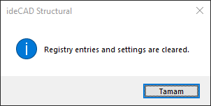

  • Hold down the Ctrl + Shift key on the left of the keyboard and run ideCAD from the desktop shortcut.
  • Keep pressing the Ctrl + Shift keys until you see a message saying "Registry entry and settings are cleared" .
  • The message may remain in the background. Observe the message that appears.
  • Click the OK button to close the dialog. When the program opens, load your project and try again.
