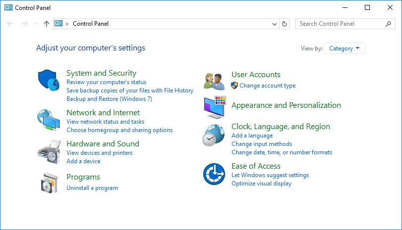

  • Enter the control panel.

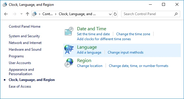

  • Click on the clock, language, and region icon.

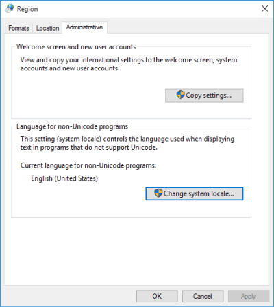

  • Click on the title of the region .
  • The region dialog will open. If you set the "Language of non-Unicode programs" option to your language in the Administrative tab, the characters will appear correctly.

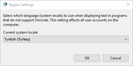

  • To do this, click on the change system locale button.
  • The region settings dialog will open. List of Your Region you select.
  • After doing the procedure, turn the computer off and on.
