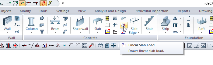

You can reach it under the Concrete tab in the ribbon menu under the Concrete topic heading.
  • Click the Linear Slab Load icon.

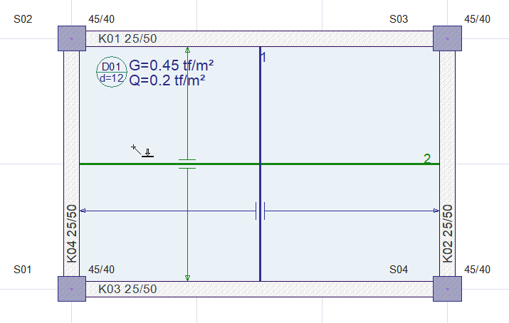

Slab before defining linear slab load

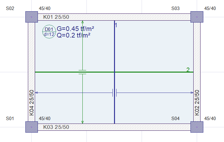

Creating the starting point of the linear slab load by clicking the left mouse button

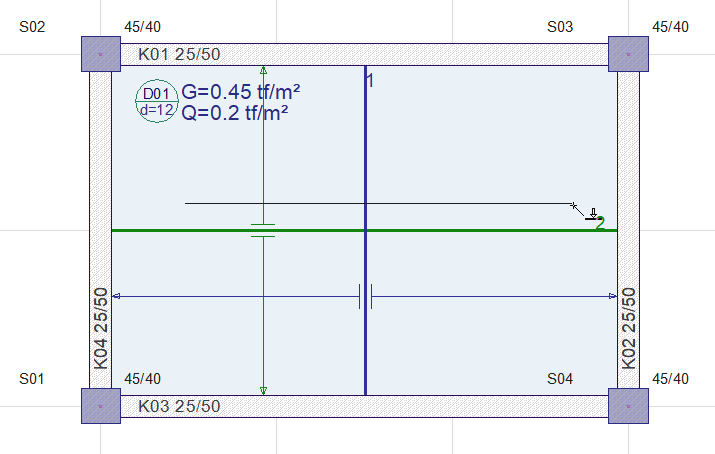

Establishing the end point of the linear slab load

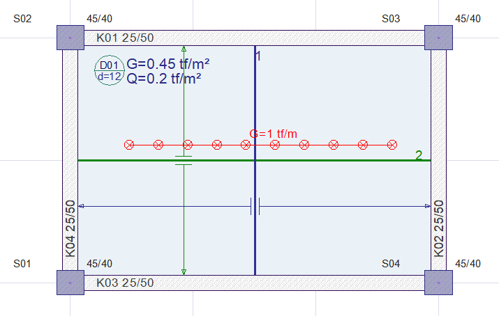

Linear slab load defined slab
Linear slab load is taken into account in rib and waffle slabs if the system is semi-rigid.

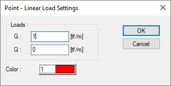

Point-Linear Load Settings Dialog
You can access the Point-Line Load Settings by double-clicking with the left mouse button on the linear slab load you have drawn.
G
If the linear/point load to be defined will be a constant load, the value is written in the G column.
Q
If the linear/point load to be defined will be a live load, the value is written in the Q column.
The drawing color of the linear/point load is adjusted in the plan. Clicking on the color box with the left mouse button, the mouse cursor is moved over the opened color palette. The key is released when the desired color is highlighted. The color box turns into the selected color.
