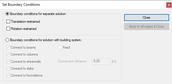

  • Click the set dome/vault restraints icon.
  • The Set Boundary Conditions dialog will open.
  • Click on the edge of the dome for which you want to change the boundary conditions.
  • In the set boundary conditions dialog, select the option you want.
  • Click the OK button to exit the dialog.
Set Boundary Conditions Dialog
Boundary conditions for separate solution
If a solution is made with the assumption of a fully rigid diaphragm, the dome is solved separately from the structure. In this case, the support conditions of the dome edges are determined by two options: rotation and translation. Dome loads should also be applied to the structure.
Translation restrained
If checked, the selected edge is restrained against translation.
Rotation restrained
If checked, the selected edge is restrained against rotation.
Boundary conditions for solution with building system
If the solution is made with the assumption of semi-rigid diaphragm, the structure - the dome is solved together. In this case, the objects to which the edges of the domes are connected are determined by the options given in the dialog.
Fixed
The edge of the dome is considered a fixed support.
Connection distance
Give the amount of distance that will be required for the dome edge to be attached to the support.
