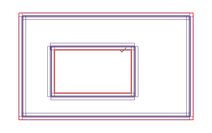

  • Move your mouse to the edge of the tile gap you want to delete.
  • The cursor will change shape.
  • When you click the left mouse button, the tile gap will be deleted.

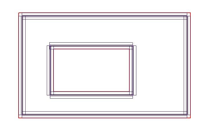

Before delete slab hole
Selecting the hole to delete

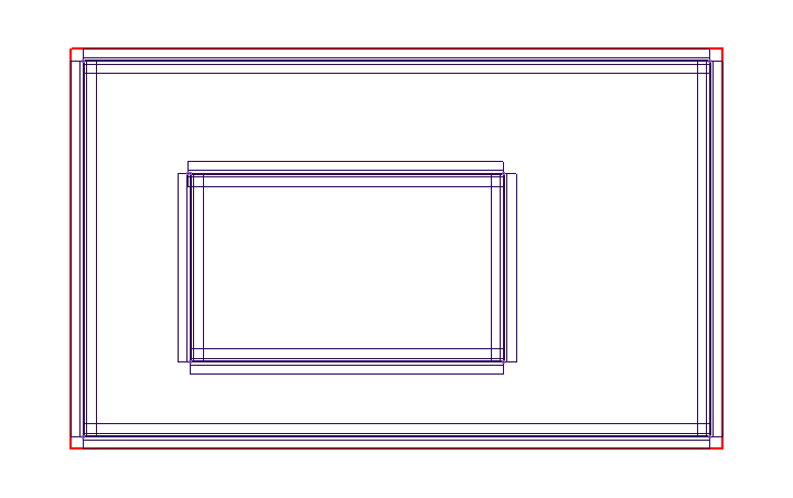

After delete slab hole
