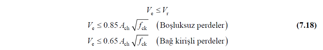

TBDY Article 7.6.7.1 - Shear strength of wall sections, V r , shall be calculated by Equation (7.17) .
The design shear force Ve defined in 7.6.6.3 will meet the conditions given in Equation (7.18) :
Otherwise, the wall transverse reinforcement and / or wall section dimensions will be increased to meet these conditions.
