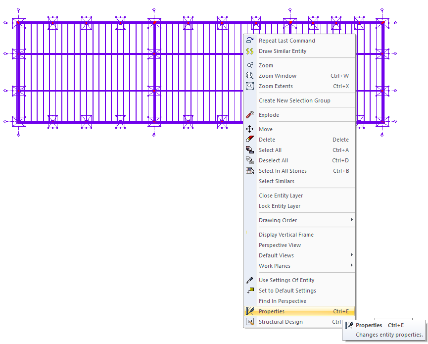

Select the hall and click the right mouse button. Click the Properties line from the right click menu that opens.

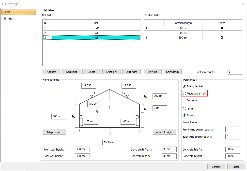

  • Enter the hall settings.
  • Select the hall you want to change the roof geometry for from the hal list.
  • Choose rectangular hall the form type section
  • The hall you choose will consist of a rectangular hall type.

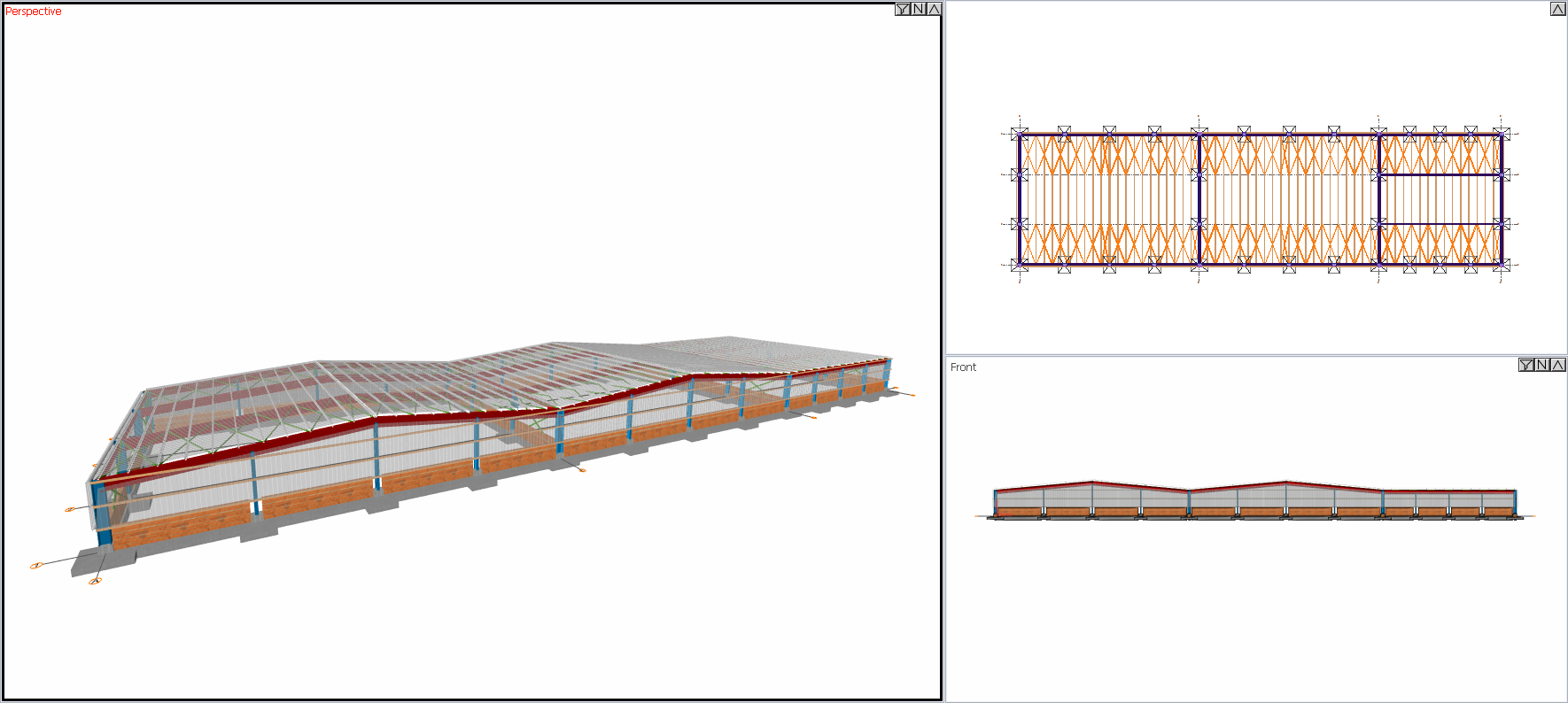

Hall view when hall 1, 2 triangular hall type and hall 3 rectangular hall type is selected
