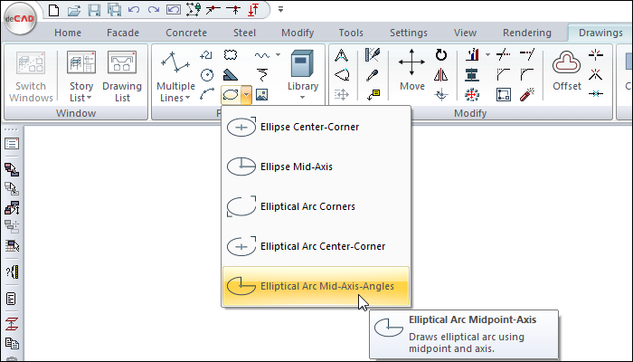

Elliptical Arc Mid-Axis-Angles command is one of the three elliptical arc drawing techniques. An elliptical arc is created by determining the midpoint (center), two points, arc start and end points.

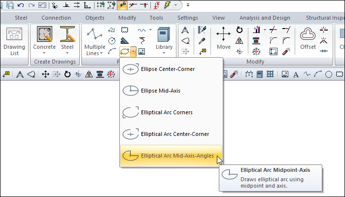

Location of the Elliptical Arc Mid-Axis-Angles Command
You can access it under the ribbon menu Drawings tab, Primitives title
In the Structural Program
To draw an elliptical arc using this command:
  • Click the Elliptical Arc Mid-Axis-Angles icon in the ribbon menu .

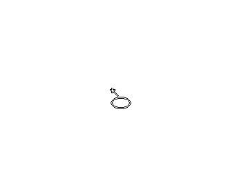

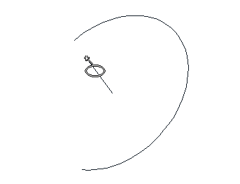

  • Click any point in the drawing area with the left mouse button. This point will be the center of the arc to be drawn.
  • Drag the mouse and click with the left mouse button to set a second point. This point will determine the size of the arc to be drawn.

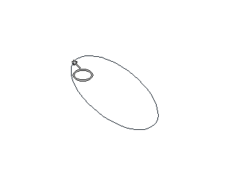

  • Drag the mouse again. Set the size of the ellipse in the other direction and left click.
  • When you drag the mouse, a piece of arc will appear on the screen. Click the left button after you have determined the length of the broadcast.

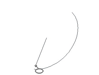

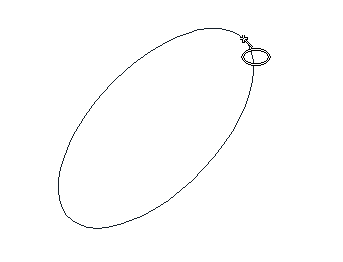

  • Drag the mouse in the opposite direction. A piece of arc will appear in the other direction. Click the left button when the spring piece is to the proper length.

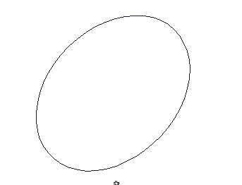

  • An elliptical arc will be drawn.
Determining the first point of the elliptical arc - arc center
Previews due to mouse movement
Determination of the second point of the elliptical arc - 1st corner
Determination of the third point of the elliptical arc - 2nd corner
Determination of the fourth point of the elliptical arc - the starting point of the arc
Determining the fifth point of the elliptical arc - the end point of the arc

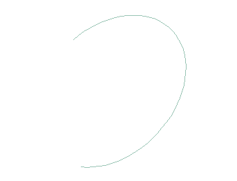

Elliptical arc formation
