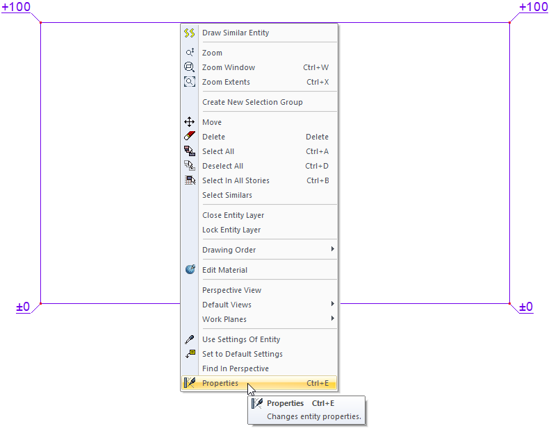

Select the terrain you want to give depth, click the right button of the mouse and click the Properties row from the menu that opens .
  • Select the terrain and click the right mouse button. Click the Properties line with the left button from the menu that opens.

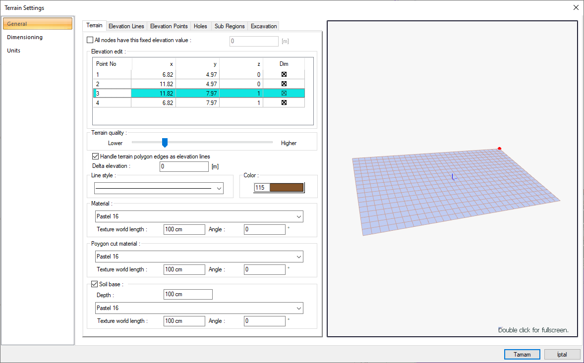

  • In the dialog that opens, check the Soil base option at the bottom.
  • Enter the value you want in the active depth line.
  • Assign a material that you find suitable for the land in the material section.

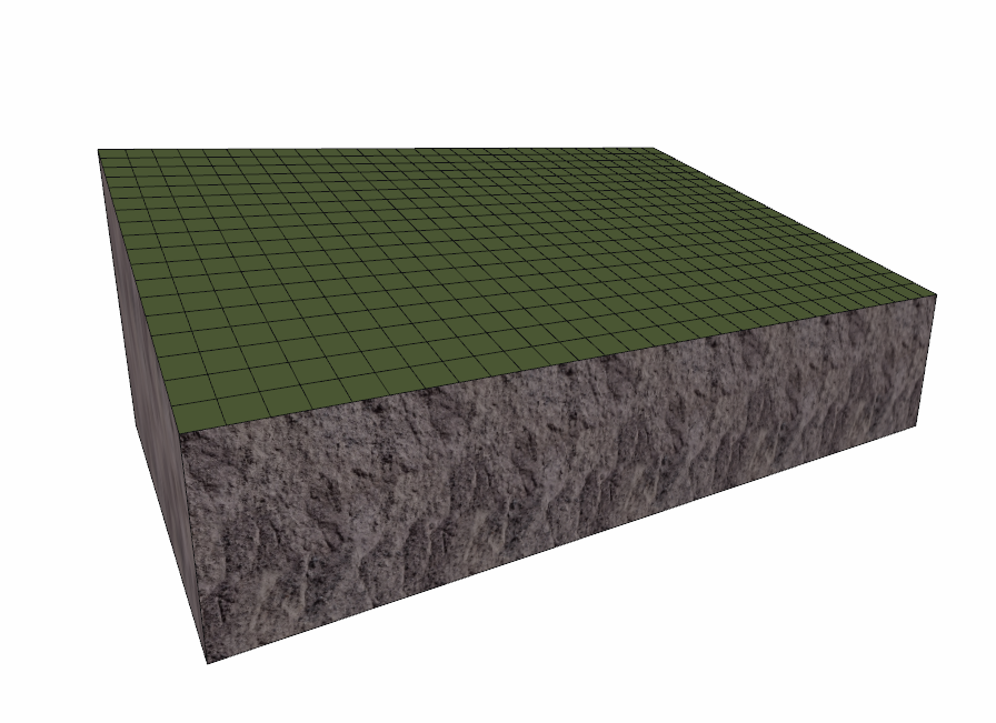

  • After this process, the land will appear as a mass on the 3D screen.

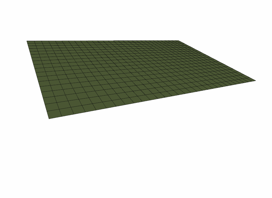

Terrain before Terrain/Depth is given
Marking the soil base feature and giving 100 cm as the depth value
Terrain after Terrain/Depth has been given
