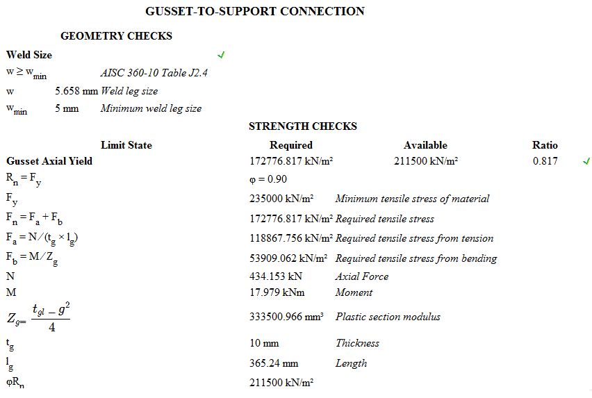

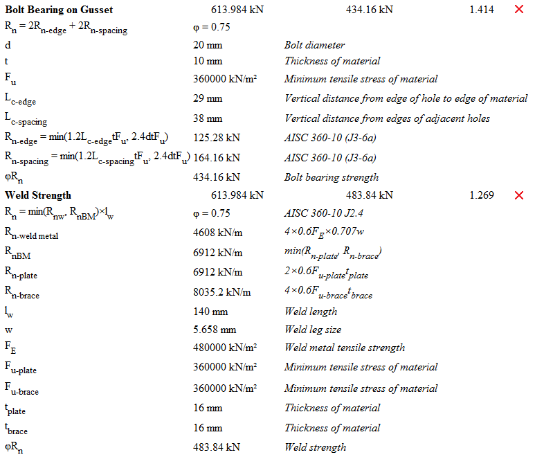

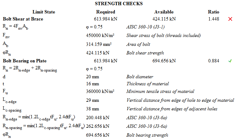

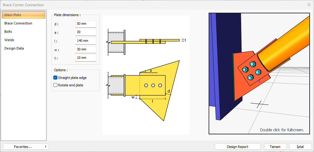

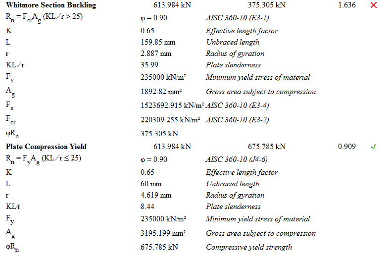

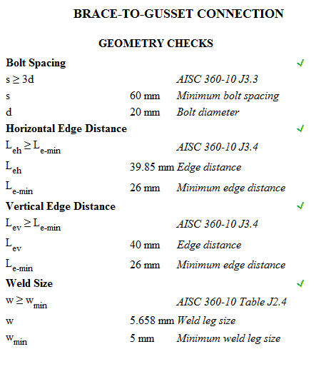

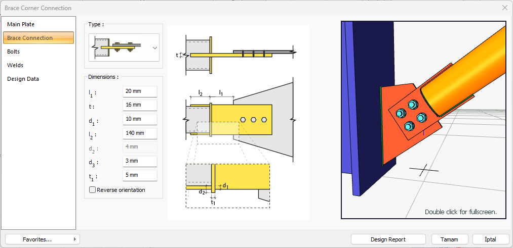

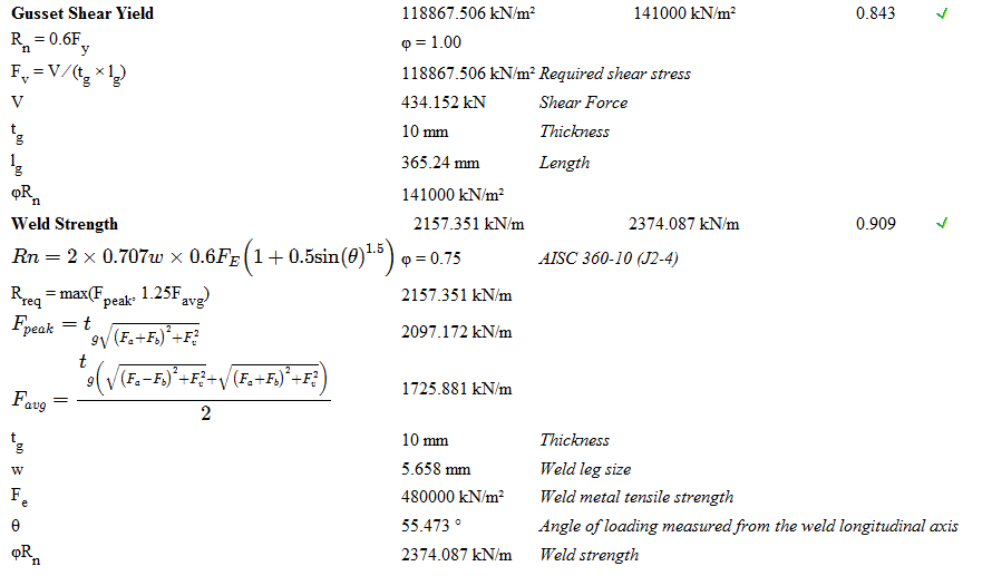

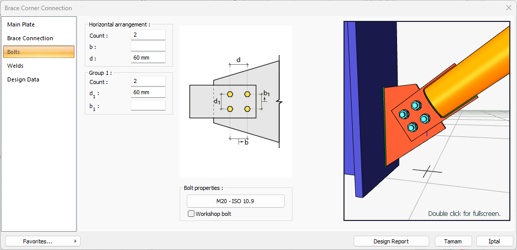

Brace Corner Connection Report
Brace corner connection design is made automatically according to the Design, Calculation and Construction Principles of Steel Structures (ÇYTHYEDY) , AISC 360-16, and the connection report is created.
