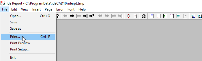

Location of Print Command
You can access the Print command from the file header .
  • Click on the Print line.
  • Select from all pages, odd pages and even pages from the page filter dialog for printing.
  • When you click the OK button, the Print dialog will open.
  • After selecting the printer and making your settings, click the OK button.
  • Your reports will be printed.
