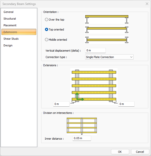

  1. The secondary beam properties menu is entered by double-clicking on the secondary beam group.
  2. The preferred connection type is selected from the "connection type" list in the Extensions tab.
  3. When the "OK" button is pressed, secondary beam connections will change.
