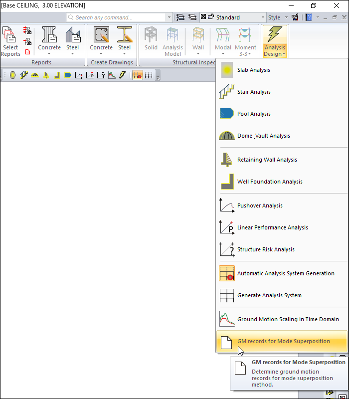

You can access the GM Records for Mode Superposition command under the Ribbon menu Analysis and Design tab Analysis heading .

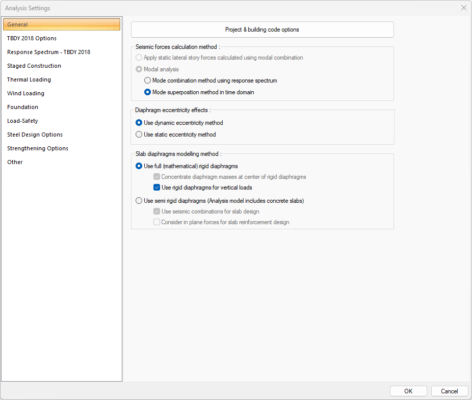

  • Click on the Analysis Settings icon.
  • In the analysis settings dialog , select Mode superposition method in time domain as the seismic forces calculation method.
  • Click the GM Records for Mode Superposition command.

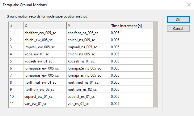

  • Enter ground motion records for mode superposition method.
