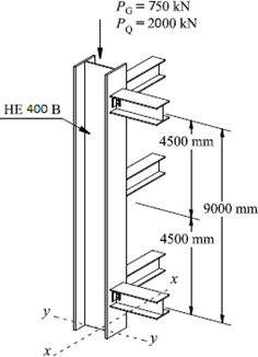

Column Design Example
Design the column under the influence of axial force, the properties of which are given in the figure below, using the ÇYTHYE 2018 regulation.

According to article 6.4.3(a) of the regulation, K= 1.0 is taken.
According to the article 8.1.1 of the regulation, the slenderness ratio of compression elements cannot exceed 200.
