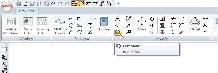

You can access it under the Drawings tab, Modify title, in 2D drawing windows .
You can also activate the command by pressing the M key on the keyboard .
  • Click the fast move icon.

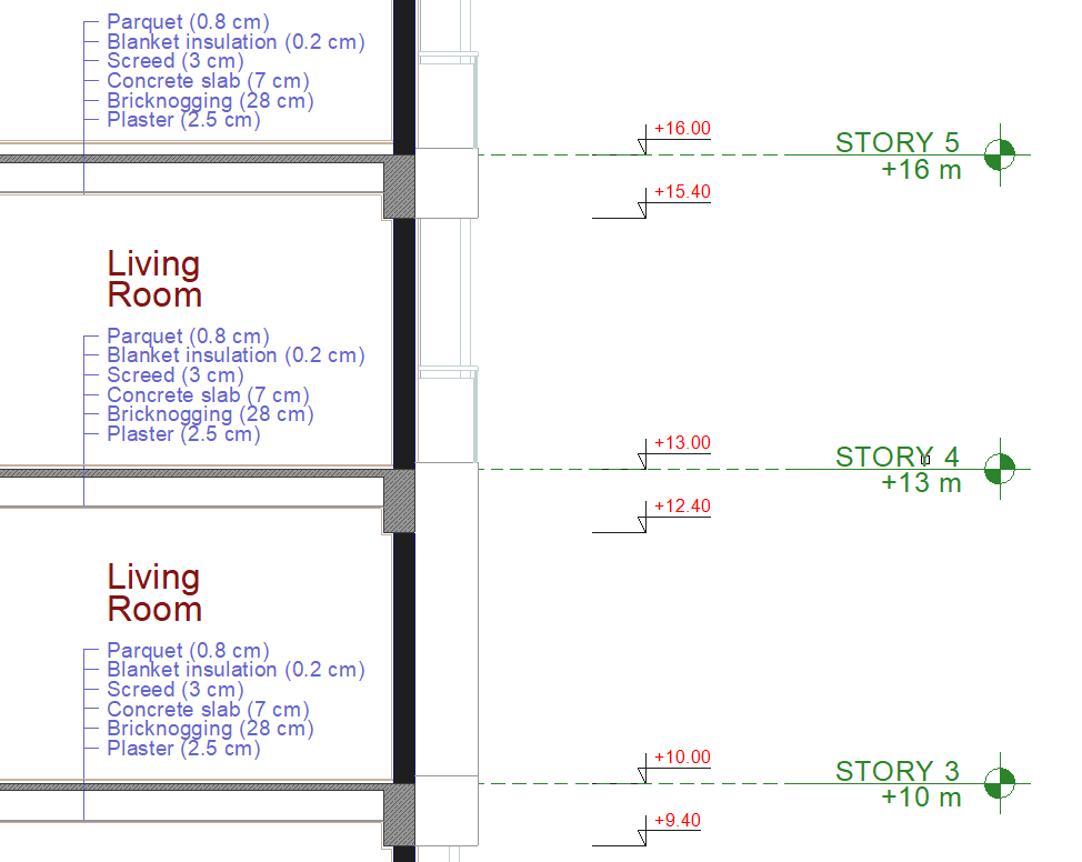

  • Click on the text in the block with the left mouse button.

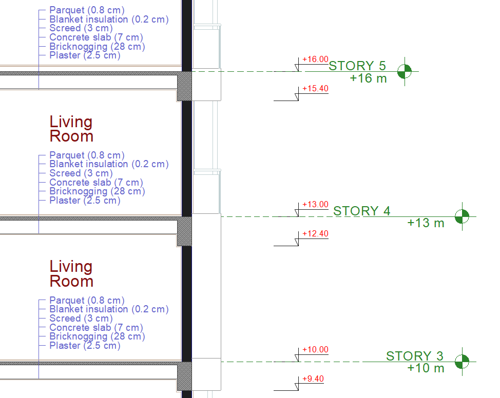

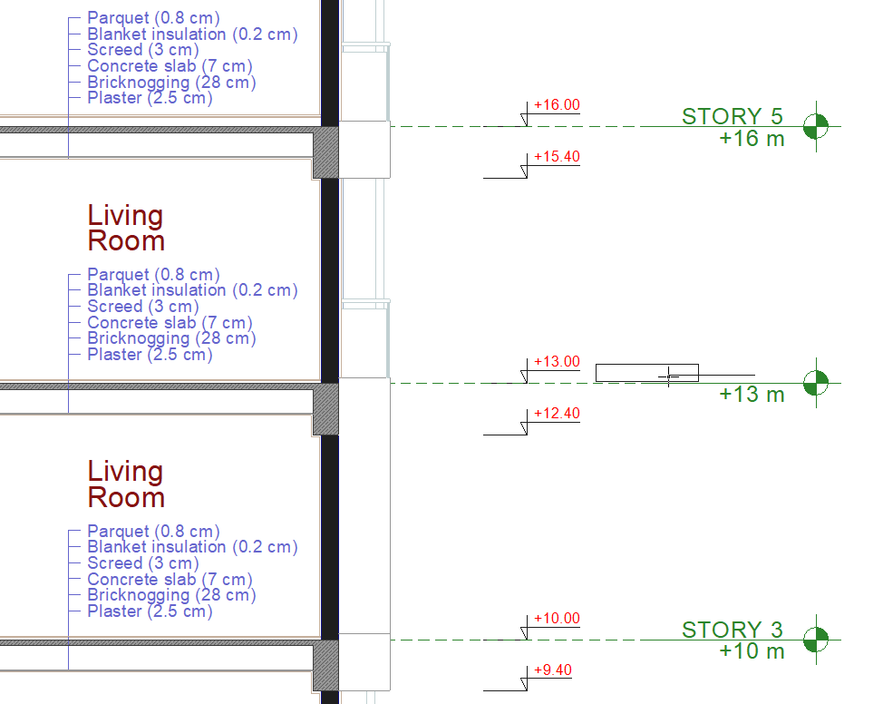

  • Click on the intended point with the left mouse button and place the text in its new place.

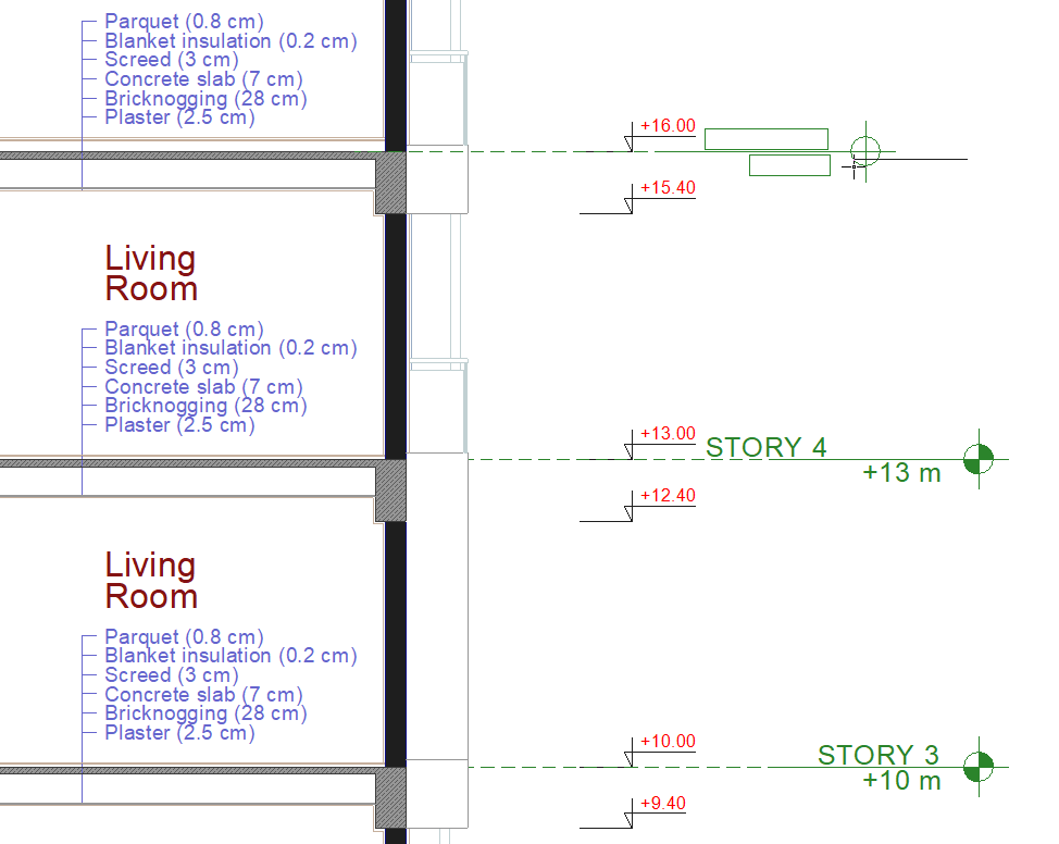

  • If you click on the drawing, it will move in the drawing along with the text.

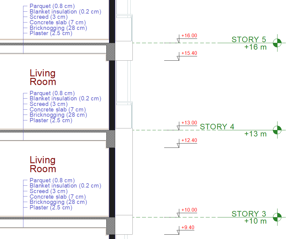

Before fast move
Selecting the text within the block
Moving to new location
Text in the block after fast move
Selecting the block
Block after fast move
