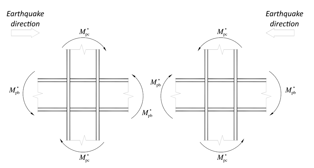

AISC 341-16 E3, and TBDY 2018 9.3.2, in the earthquake direction considered, at each beam-column node of highly ductile steel frames with special moment frame. The following relationship shall be satisfied at beam-to-column connections.
Column-Beam Moment Ratio Check for SMF per AISC 341-16 with ideCAD
Solutions:
  • The cross-sectional dimensions of columns whose names and floors are given can be enlarged.
  • Columns can be connected to beams in the direction of their strong axes.
  • If the structure is suitable, beam dimensions can be reduced accordingly.
Symbols
Mpc : Sum of the projections of the nominal flexural strengths of the columns above and below the joint
Mpb : Sum of the projections of the expected flexural strengths of the beams at the plastic hinge locations to the column centerline, kip-in.
