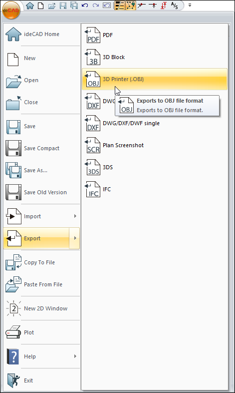

You can access it from the menu under the ideCAD logo in the upper left corner of the screen in the ribbon menu.
  • Click the İdeCAD logo in the upper left corner.
  • Click the Export/3D Printer (.OBJ) line from the menu that opens.
  • In the dialog that opens, a name is written on the File name line.
  • Click OK button

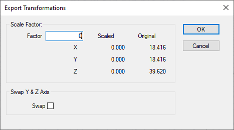

  • The export transformations dialog will open.
  • In this dialog, the necessary selections are made and the OK button is clicked.
Export Transformations Dialog

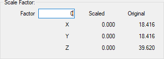

Scale factor
The drawing is enlarged/reduced according to the entered value.
Swap Y&Z axis
Coordinate axes can be changed if needed.
