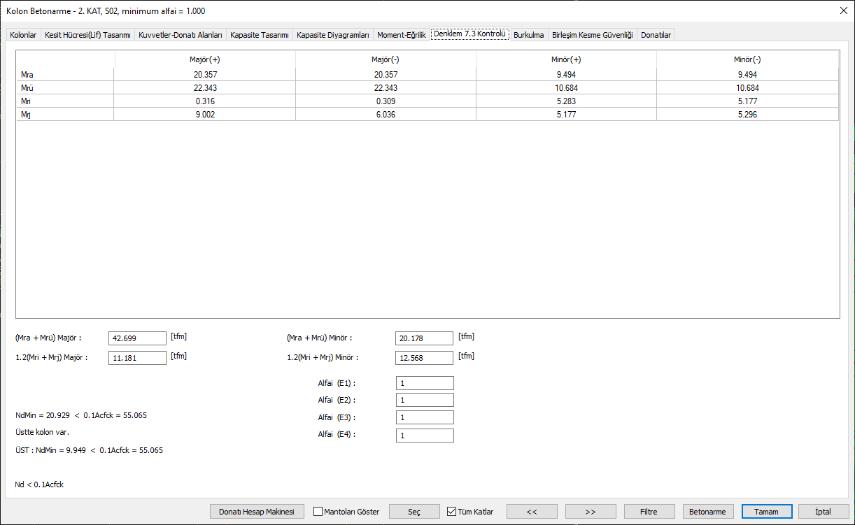

Strong Column Condition Example
 In the column reinforced concrete dialog, moment capacities and beam bearing moments in major and minor directions can be seen at the upper and lower joint points.
It will be checked whether the conditions are met for the 2nd story S02 column.
In Major 3: Mra + Mrü = 42.874 tfm > 1.2(Mri+Mrj) =6.889 tfm is provided.
In the minor 2 direction: Mra + Mrü = 17,608 tfm > 1.2(Mri+Mrj) =13.624 tfm is provided.
