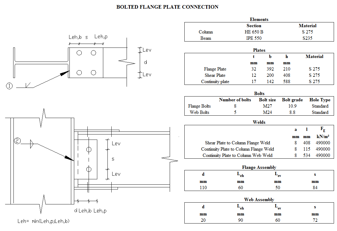

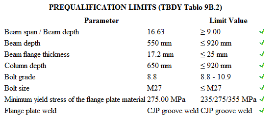

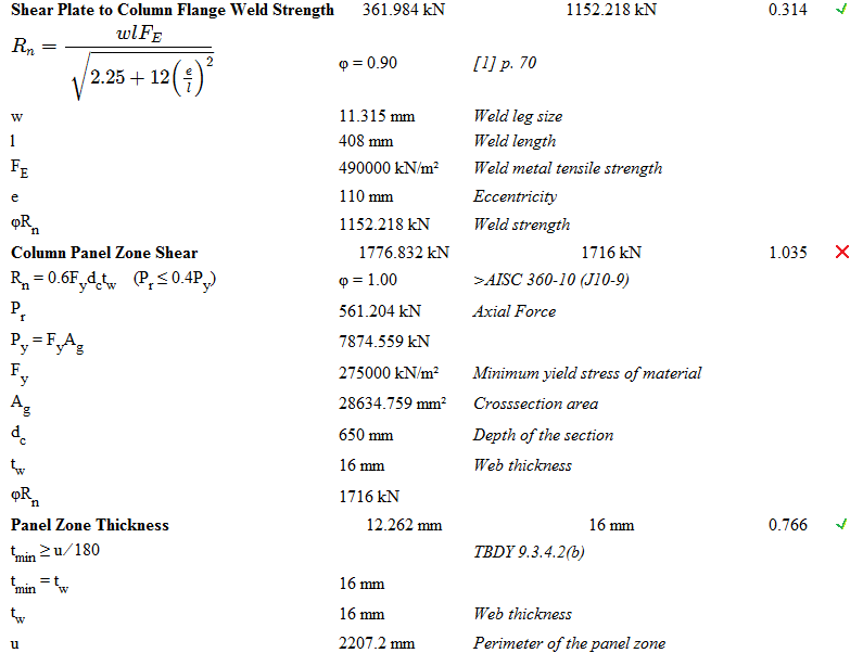

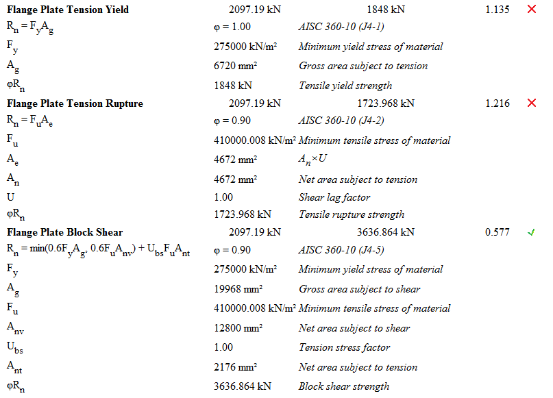

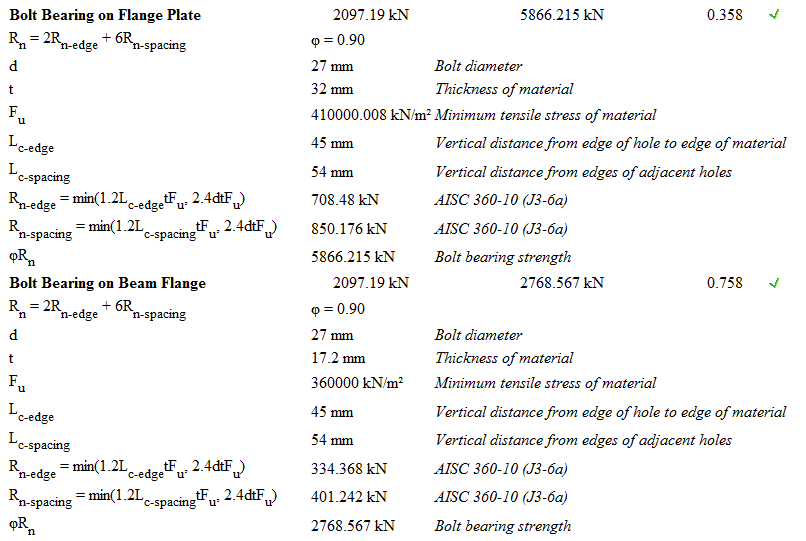

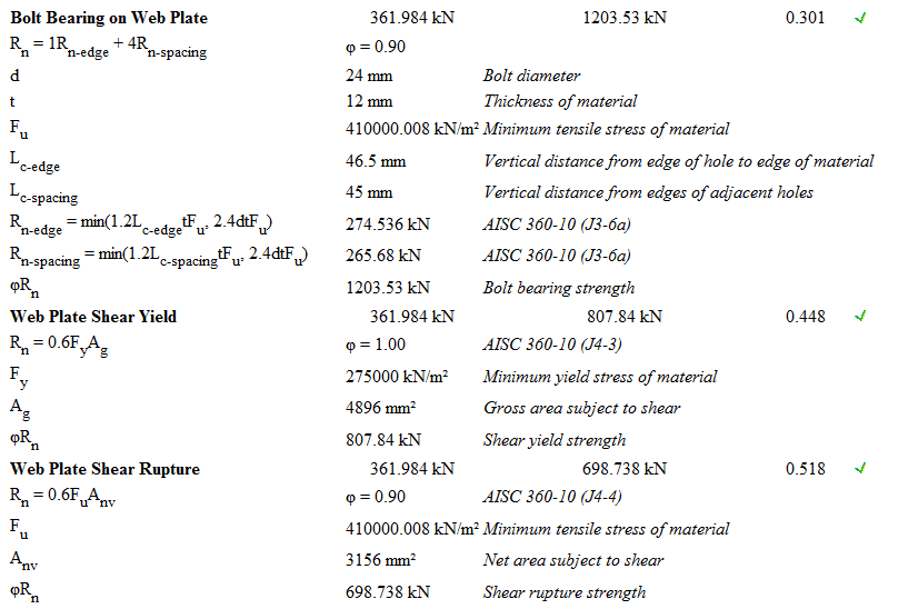

Bolted Flange Plate Connection Report 2

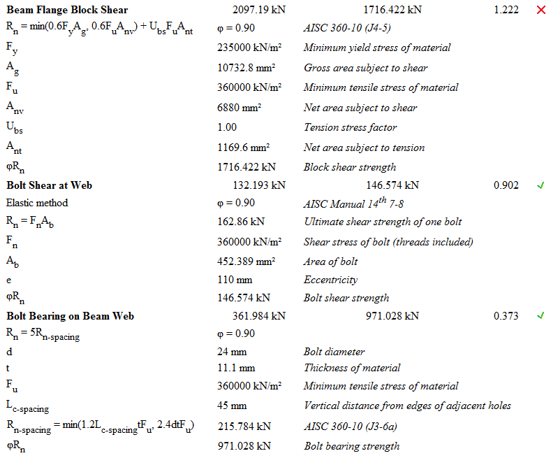

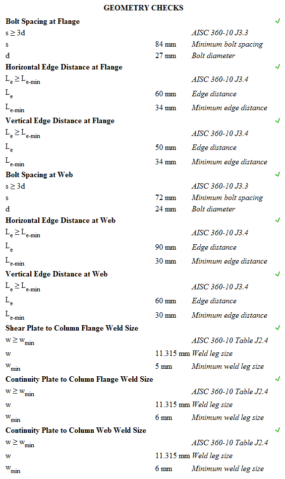

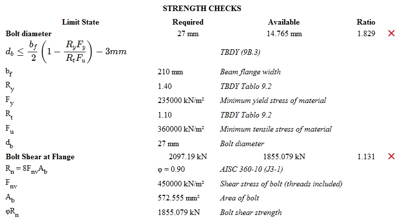

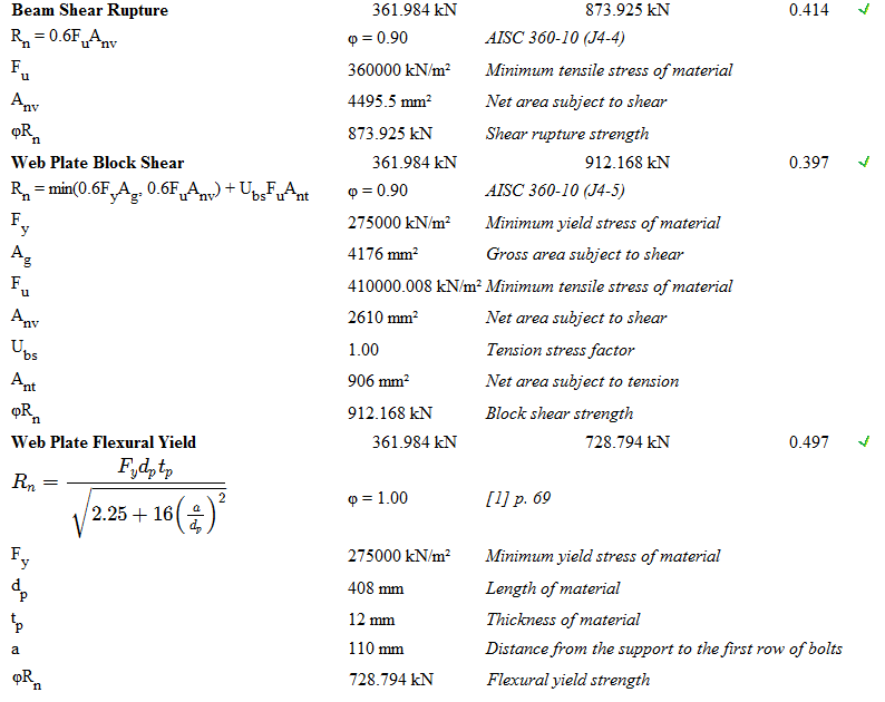

Bolted Flange Plate Connection design is made automatically according to the Design, Calculation and Construction Principles of Steel Structures (ÇYTHYEDY) , AISC 360-16, AISC 358-16 and TBDY regulations and a connection report is created.
