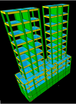

  • Buildings that continue as a single block on the lower stories and as independent towers on the upper stories
In such structures, you do not have the chance to solve them as different projects. Therefore, you have to solve the project according to more than one rigid diaphragm acceptance in stories.

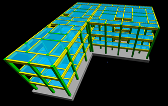

  • Common foundations
  • Structures with dilated foundations
The most suitable method for solving these types of structures is to model the building as different projects.
