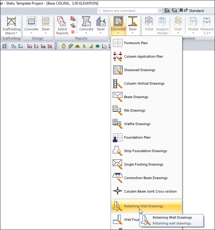

Location of the Retaining Wall Drawings Command
You can access it under the ribbon menu Concrete tab, Create Drawing heading.
  • Click the Retaining Wall Drawings icon.

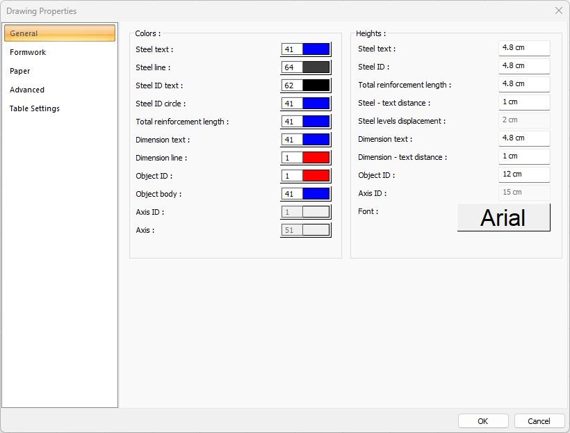

General Tab
Specifications - Colors
Steel text
Steel line
Steel ID text
Steel ID circle
Total reinforcement length
Dimension text
Dimension line
Object ID
Object body
Specifications - Heights
Steel text
Steel ID
Steel - text distance
Dimension text
Dimension - text distance
Object ID
Font

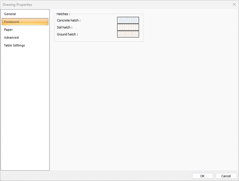

Formwork Tab
Concrete hatch
It is the hatch type that is valid for concrete. Clicking on hatch opens the Hatch Settings dialog. The hatch type is selected from the lookup table in this dialog.
Soil hatch
It is the hatch type that is valid for the soil. Clicking on hatch opens the Hatch Settings dialog. The hatch type is selected from the lookup table in this dialog.
Ground hatch
It is the hatch type that is valid for the ground. Clicking on hatch opens the Hatch Settings dialog. The hatch type is selected from the look-up table in this dialog.

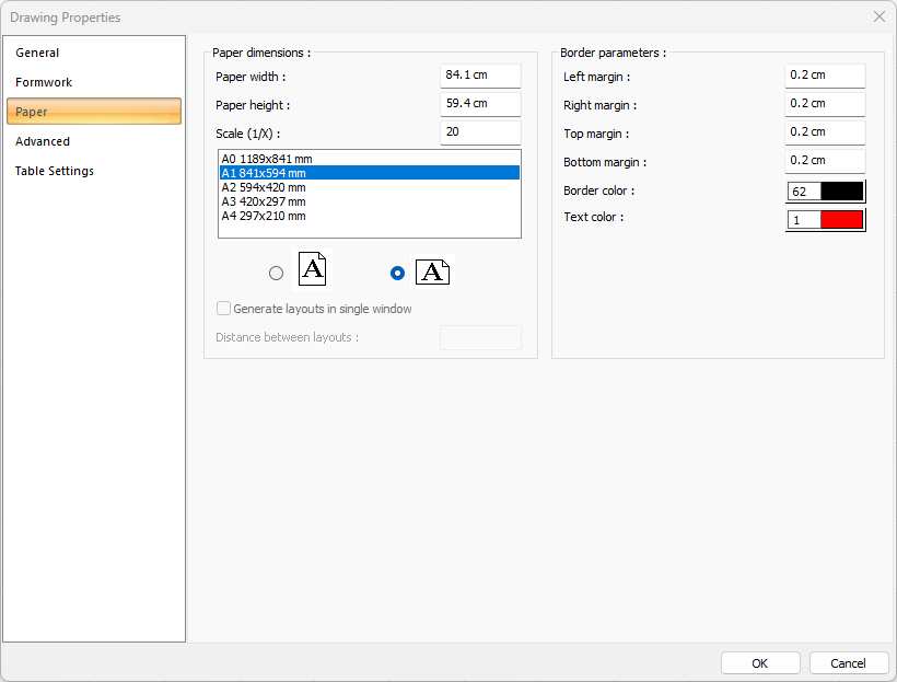

Paper Tab
Paper width
Paper height
Scale (1/X)
Standard paper sizes
Vertical/Horizontal use
Distance between layouts
Left margin
Right margin
Top margin
Bottom margin
Border color
Text color

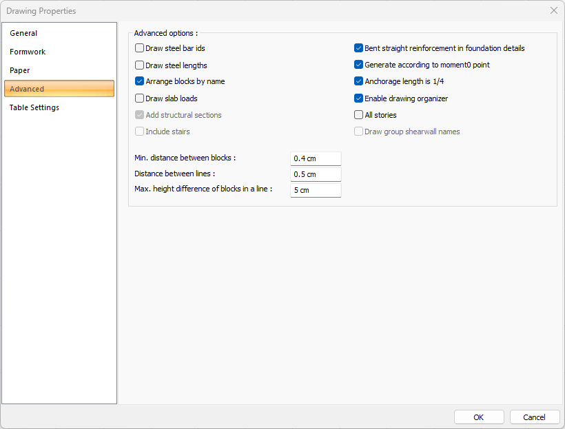

Advanced Tab
Draw steel bar ids
Draw steel lengths
Arrange blocks by name
Draw slab loads
Anchorage length is 1/4
Enable drawing organizer
All stories
Min. distance between blocks
Distance between lines

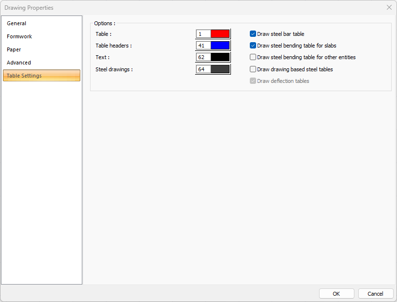

Table Settings
Table
Table header
Text
Steel drawings
Draw steel bar table
