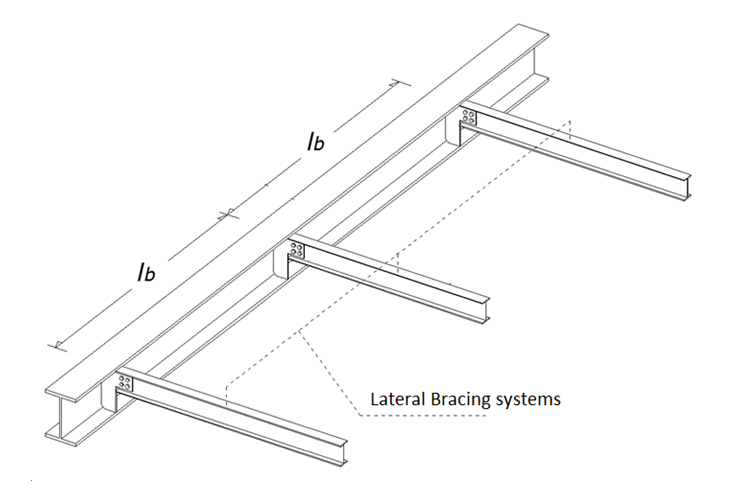

Mr = Required flexural strength, kip-in. (N-mm)
Lb = Length between points which are either braced against the lateral displacement of compression flange or braced against twist of the cross-section, in. (mm)
ry = Radius of gyration about y-axis, in. (mm)
Z = Plastic section modulus about the axis of bending, in.3 (mm3)
αs = LRFD-ASD force level adjustment factor 1.0 for LRFD and 1.5 for ASD
Stability bracing should be provided to restrain the lateral-torsional buckling of structural steel designated as moderately ductile members.
According to Equation D1-2, the bracing of moderately ductile beam members should have a maximum spacing of:
