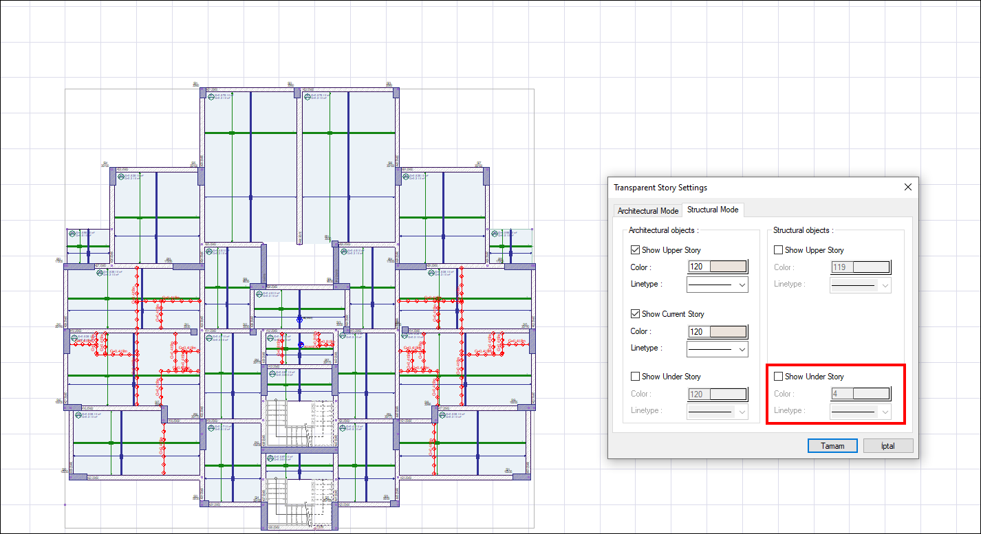

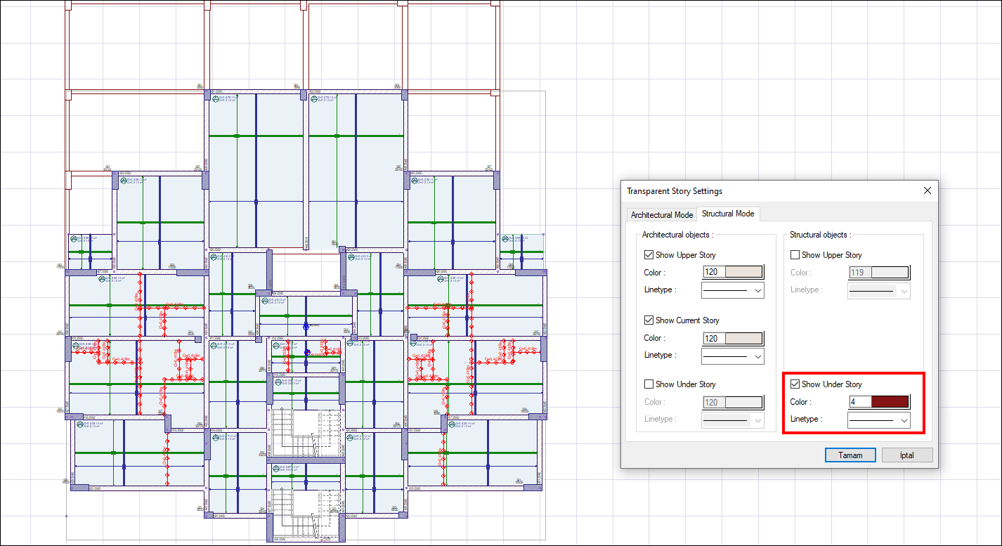

With the "Transparent Story Setting" feature in the View section of the menu, whether the architectural and structural objects on the upper and lower stories will be visible on the active story, and with which line types the view will be made, can be set.
Drawings are completed by catching the nodes of the guide lines and referencing the lower or upper stories.
For example; while on the ground story plan, the roof is drawn by seeing the walls of the lower story, or on the architectural story plan, by seeing the formwork plan mode, the designs are directed accordingly.
