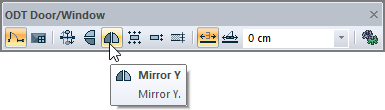

You can access it from the door/window toolbar.

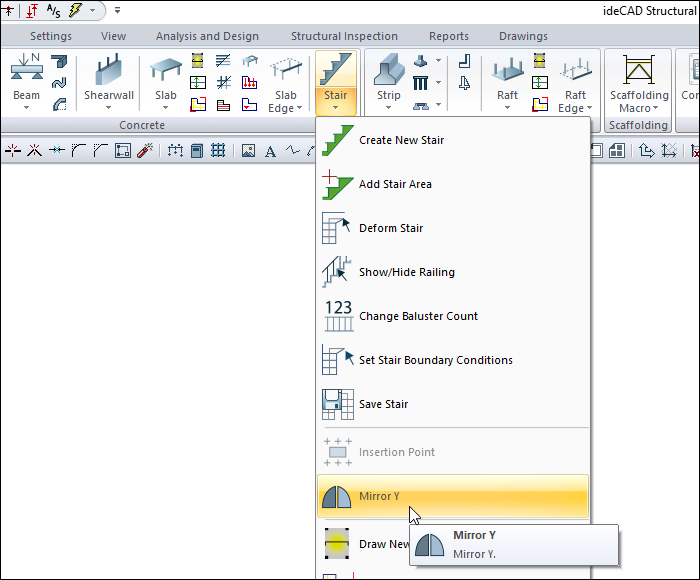

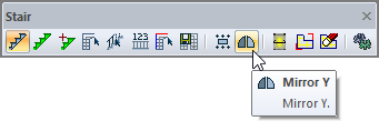

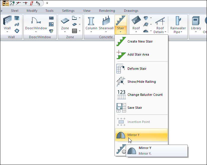

You can access it from the stair toolbar.
You can access it from the home tab of the architectural program, under the heading of concrete.

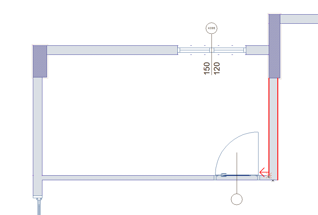

Door before mirror Y
Door after mirror Y

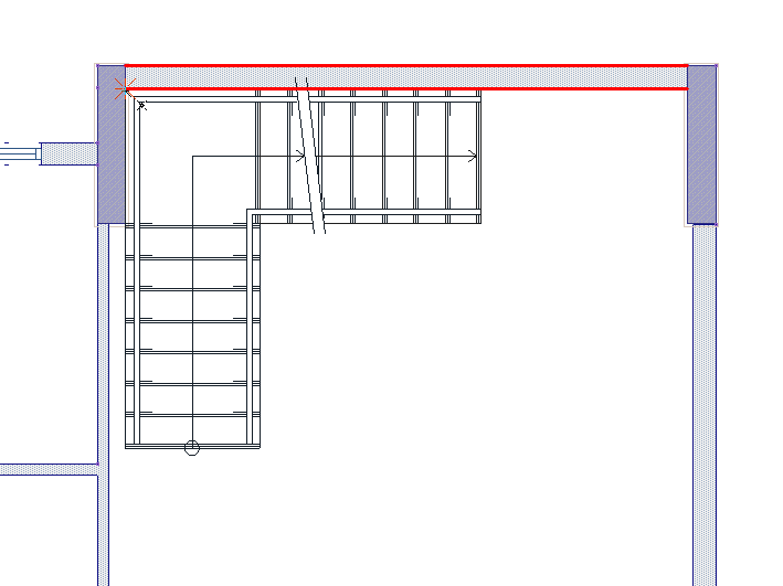

Stair before mirror Y

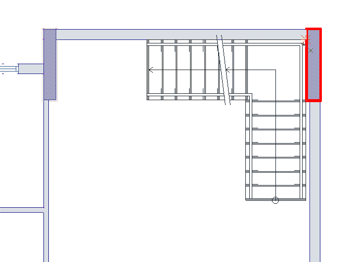

Stair after mirror Y
