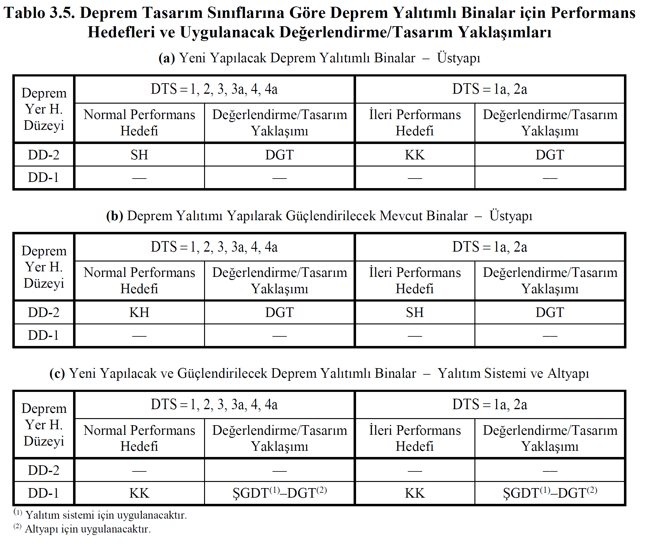

3.5.2. Evaluation / Design Approaches to be Applied
3.5.2.1 - Scopes of application of Design Based Resistance (DOT) approach given in Section 4 and Evaluation and Design Based on Change (ŞGDT) approach given in Section 5 are given in Table 3.4 and Table 3.5 .
3.5.2.2 - Preliminary design of fully post- tensioned pre-fabricated buildings defined in Chapter 8 will be made with the DGT approach, and the final design will be done with the ŞGDT approach according to 8.4.3 .
3.5.2.3 - The design of masonry, timber and light steel buildings not specified in Table 3.4 will be made with the Design Based on Strength (DGT) approach according to Chapter 4 .
