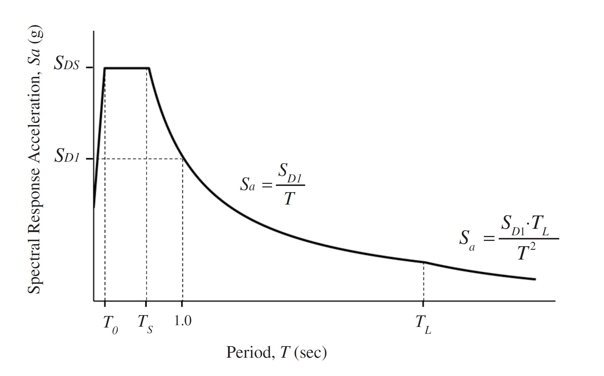

Horizontal elastic design spectral accelerations Sa are defined in terms of gravity [g] depending on the natural vibration period.
With the spectral response acceleration parameters obtained from USGS depending on the coordinates, the horizontal elastic design spectrum Sa is determined according to the formula below. It is represented by a total of 4 functions, different in each region. It is shown in the graph below.
  • It’s determined with the equation 11.4-5 from T=0 to T0 .
  • It’s equal SDS from T0 to Ts .
  • It’s determined with the equation 11.4-6 from Ts to TL .
  • It’s determined with the equation 11.4-7 for periods greater than TL.
