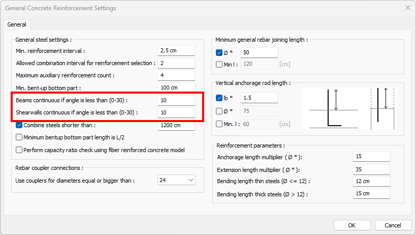

Beams/Shearwalls Continuous if Angle is Less Than
In order to continuously draw the longitudinal reinforcement of the shearwalls or beams that are angled in the plan view, the "Beams/Shearwalls continuous if angle is less than (0-30)" options are used. In the General Concrete Reinforcement Settings dialog, an angle of up to 30 degrees can be entered in the "Beams/Shearwalls continuous if angle is less than (0-30)" options. This options allows the reinforcements of shearwalls and beams modeled with fractures to be drawn continuously.
