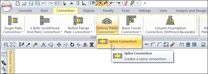

Location of the Splice Connection Command
  • Click on Splice Connection from the Connection menu.
  • The splice connection settings dialog will open.

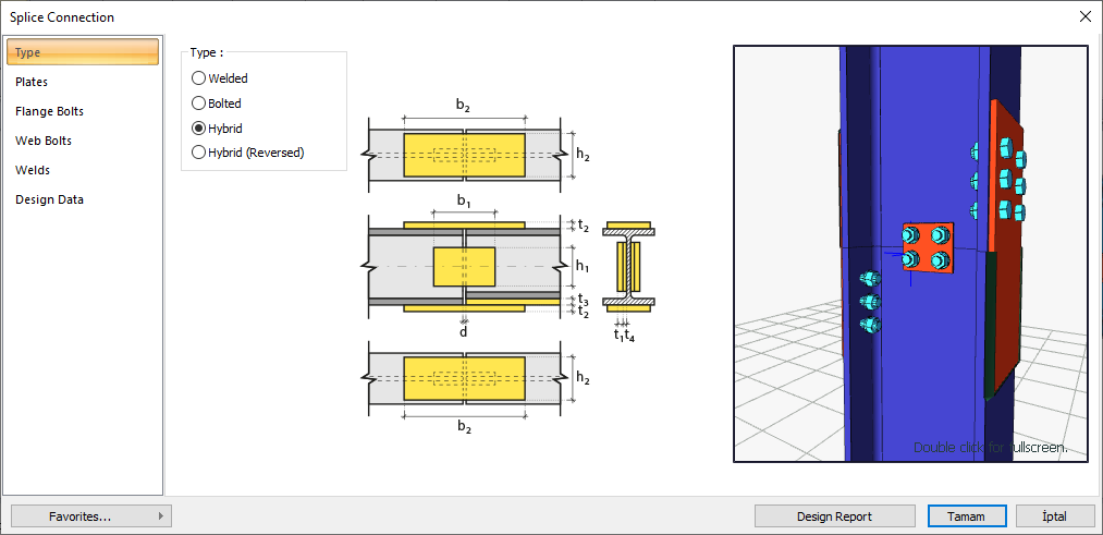

Type Tab
Type
For the connection, one of the welded, bolted, hybrid or hybrid (reversed) connection types is selected.
The connection is shown on the schematic drawing.

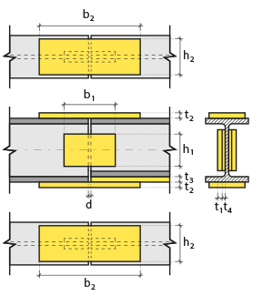

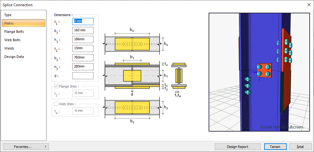

Plates Tab
Dimensions
Plate sizes are determined by entering values. The values ​​to be entered are shown in the schematic drawing.
Flange shim
Shim is a plate placed between the elements to be connected in bolted connections. If shim will be made, the option is checked and t 3 , thickness value is given.
Web shim
Shim is a plate placed between the elements to be connected in bolted connections. If shim is to be made, the option is selected and t 4 , thickness value is given.

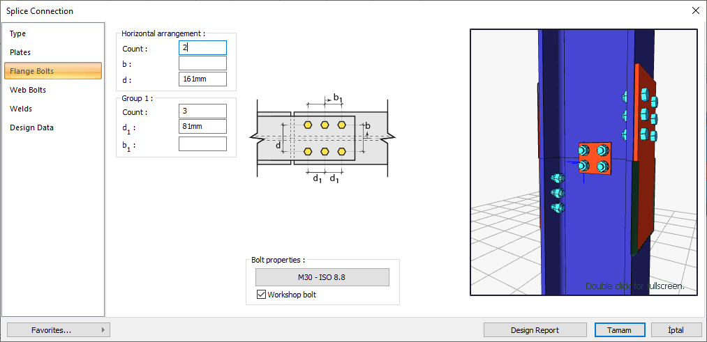

Flange Bolts Tab
Horizontal arrangement
The horizontal arrangement distance value and number of bolts are entered. The values ​​to be entered are shown in the schematic drawing.
Group 1
Bolt distance values ​​are entered. The values ​​to be entered are shown in the schematic drawing.
Bolt properties

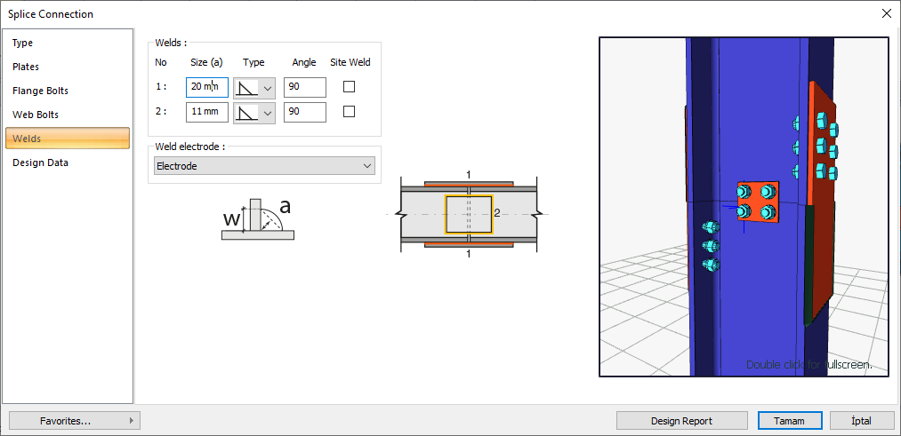

Welds Tab

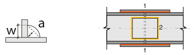

Welds
Weld electrode

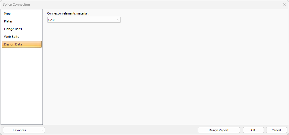

Design Data Tab
