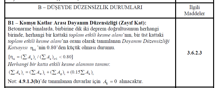

B1 Strength irregularity between adjacent floors In reinforced concrete buildings, in either of two perpendicular earthquake directions, Strength Irregularity Coefficient ηci , defined as the ratio of the total effective shear area on any floor to the total effective shear area on the next floor , is less than 0.80. is the case
Definition of effective cutting area on any floor:

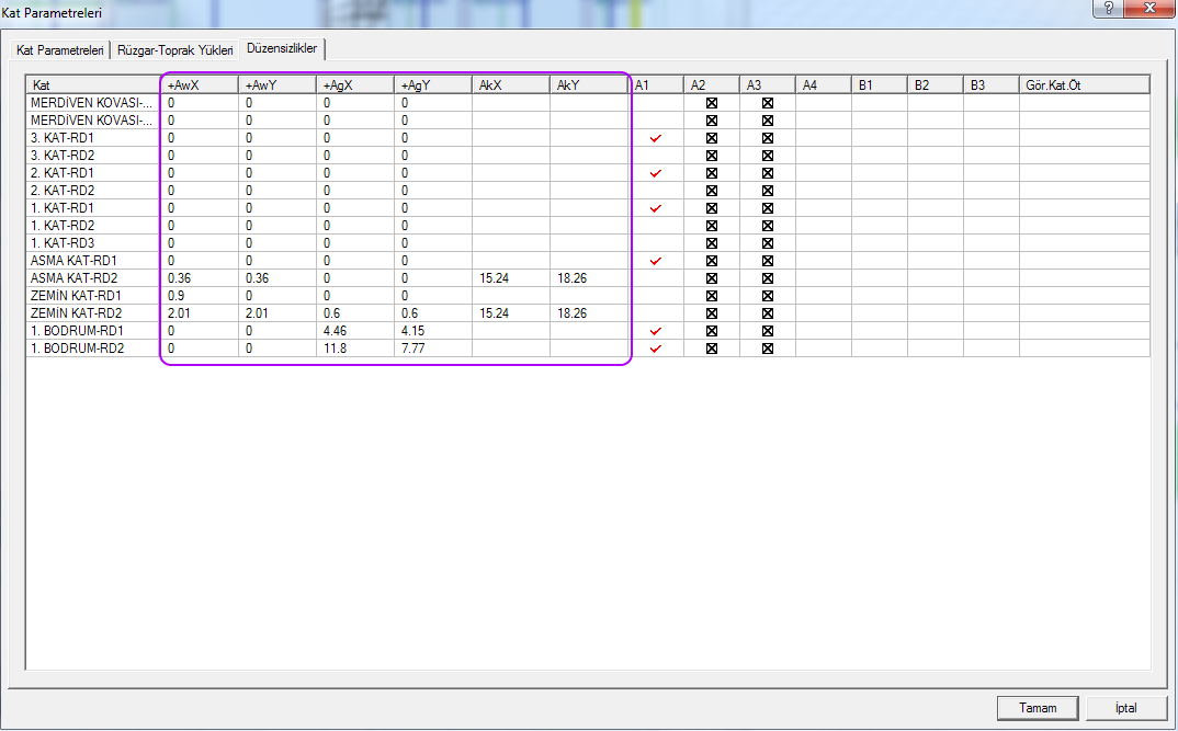

  • In case there is more than one diaphragm in a floor (for example, in mezzanine, etc. floors, floor masses may be independent of each other and some columns/walls may not be connected to the diaphragms (floors).) not included. If it is desired to be included, it can be manually added to the Aw and Ag columns in the Floor parameters/Irregularities tab at the user's initiative.

  • The cutting areas are given in the Irregularities tab of the Floor Parameters dialog and the values ​​can be changed as in the example image below.
