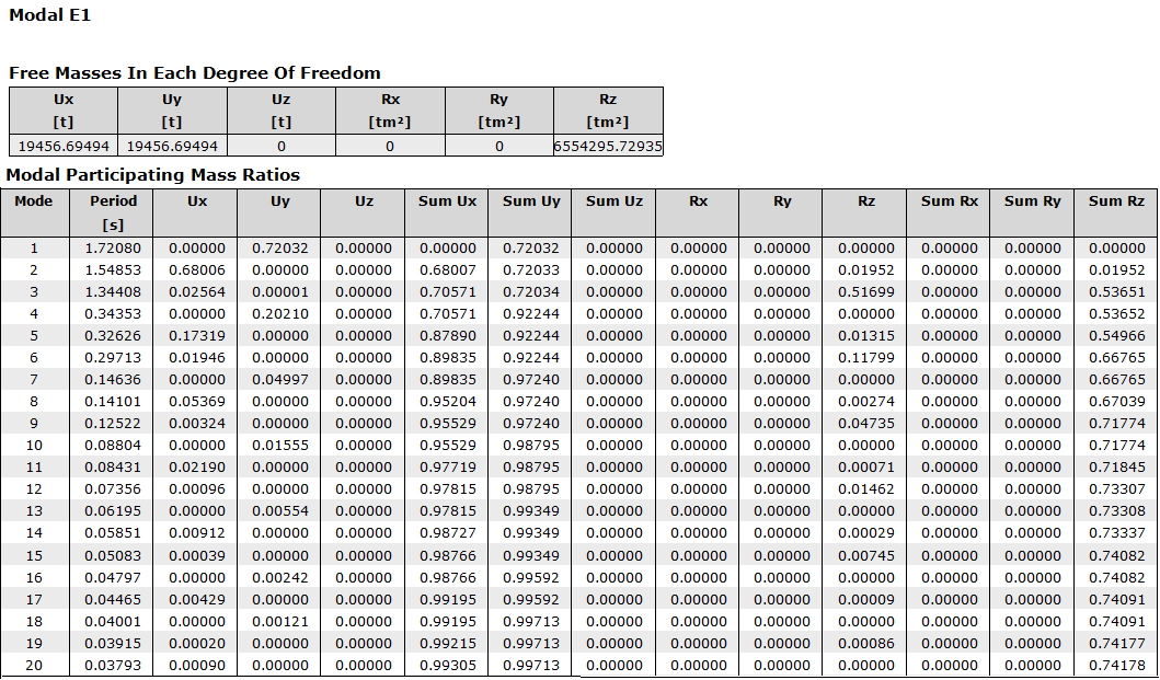

  • The table below summarizes the upper section dynamic analysis results obtained from the models where the frame columns are hinged and monolithically connected.
- Articulated Case
-Monolithic Situation

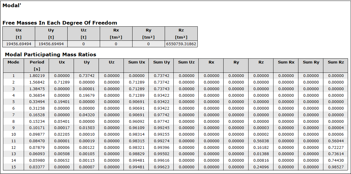

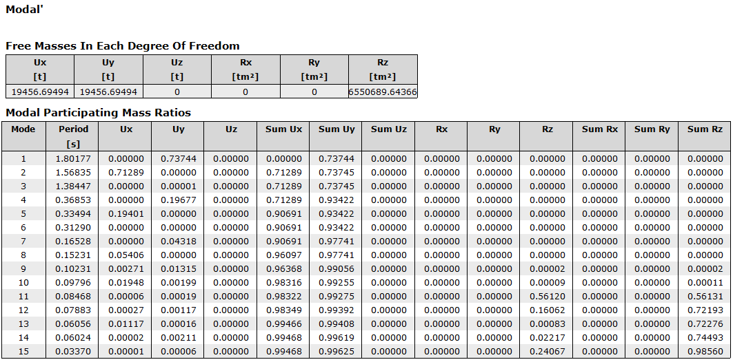

  • In slabs that are modeled as shells and accepted as semi-rigid diaphragms in accordance with TBDY 2018 4.5.10.4 article, a fully rigid solution is also applied to determine the accidental torsion. The above solutions are fully rigid due to earthquake regulations.
  • The data obtained as a result of dynamic analysis suitable for the semi-rigid diaphragm are summarized in the table below. In this solution, it has to be made in 2 stages, hinged and monolithic. Below are the results of the monolithic solution.

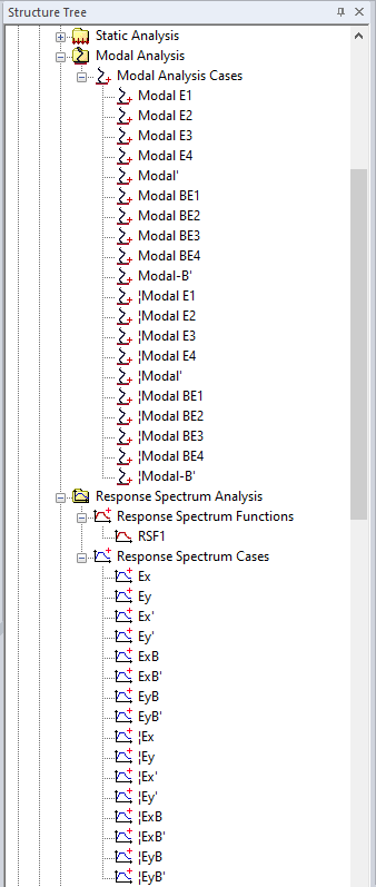

  • The list of all modal analyzes made in the program can be viewed in the structure tree section of the interface.
