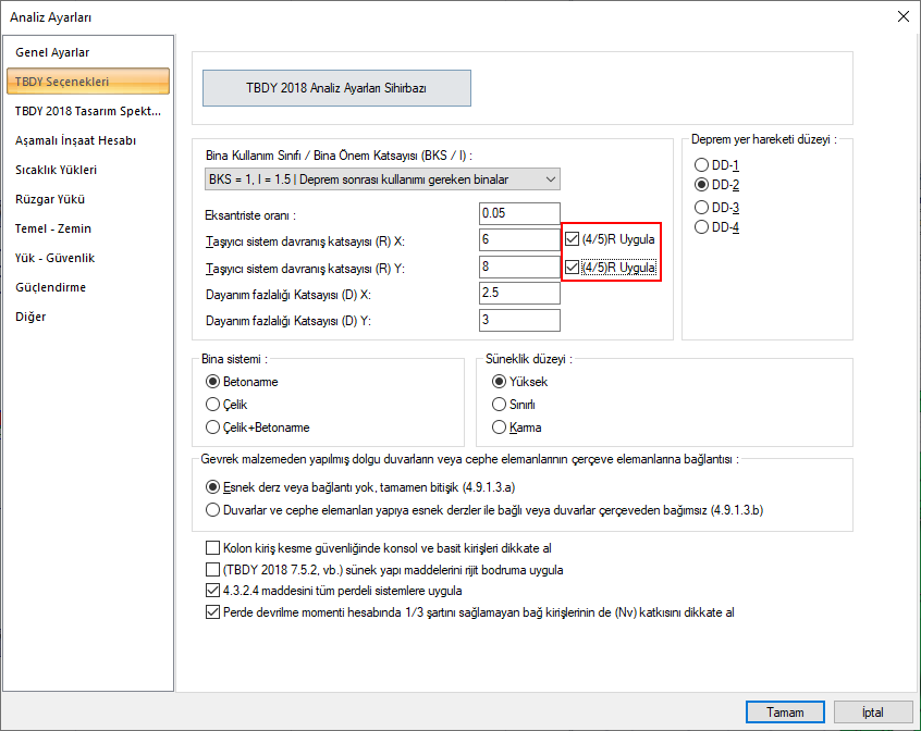

Possible solutions:
  • By adding a sufficient amount of edge curtains, following the repetition of the analysis, the above-mentioned (b) conditions are met.
  • (b) If the conditions are not met, the "(4/5) R apply" option in the Analysis Settings / TBDY Options Tab is checked in the requested direction and the analysis is repeated.
