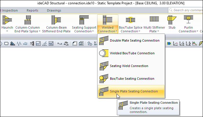

Location of the Single Plate Seating Connection Command
  • Click the Single Plate Seating Connection icon from the Connection menu.

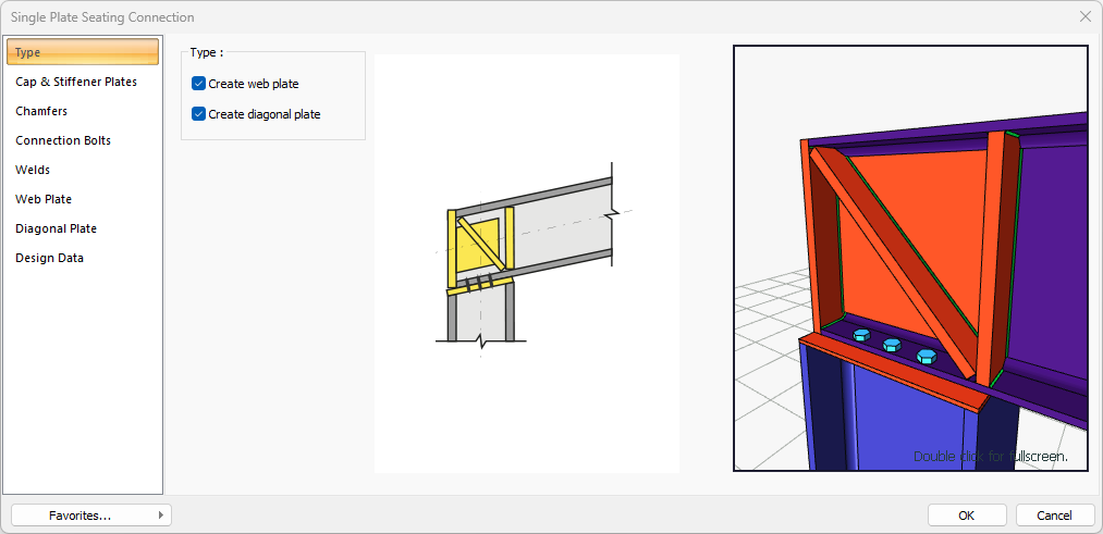

Type Tab
Type

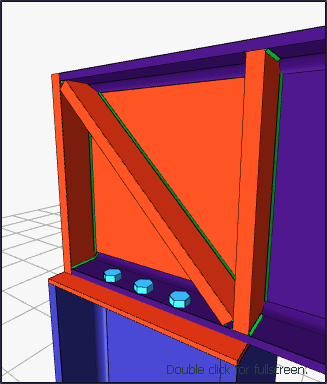

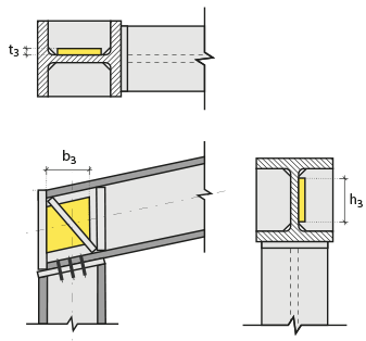

Web and diagonal plate selections are made for combination.
Connection is shown on the schematic drawing.

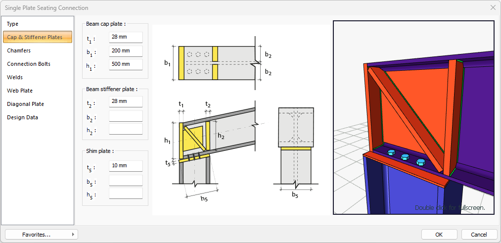

Cap and Stiffener Plates Tab

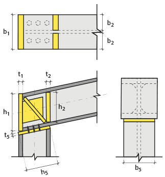

Beam cap plate
The beam cap plate is determined by entering the value. The values ​​to be entered are shown in the schematic drawing.
Beam stiffener plate
Beam stiffener plate is determined by entering the value. The values ​​to be entered are shown in the schematic drawing.
Shim plate
Shim is a plate placed between the elements to be connected in bolted connections. If shim is to be made, the option is selected and t2, thickness value is given.

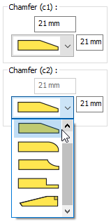

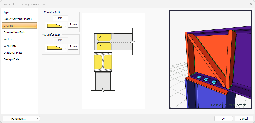

Chamfers Tab
Chamfer (c1, c2)

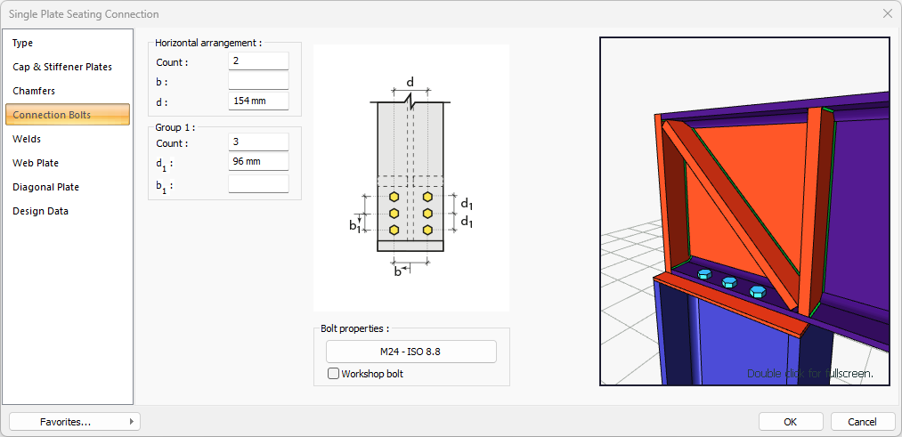

Connection Bolts Tab
Horizontal arrangement
Group 1
Bolt properties

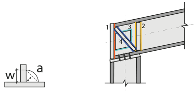

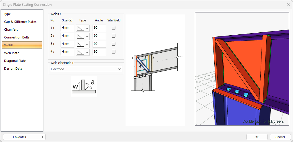

Welds Tab
Welds
The thickness, type and angle values ​​of the welds to be made at the joints are given. The information on whether it will be done on the construction site or not is entered.
Weld electrode

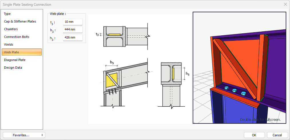

Web Plate Tab
Web plate
The web plate is determined by entering the value. The values ​​to be entered are shown in the schematic drawing.

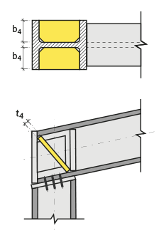

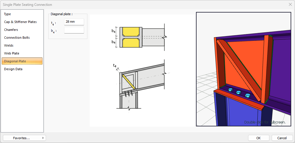

Diagonal Plate Tab
Diagonal plate
The diagonal plate is determined by entering the value. The values ​​to be entered are shown in the schematic drawing.

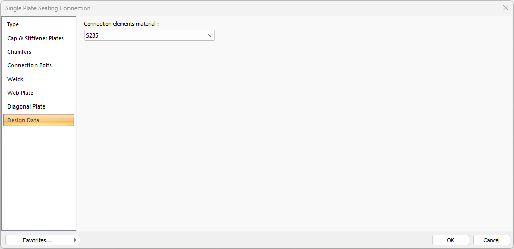

Design Data Tab
