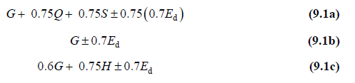

4.4.4.2 - In steel and light steel buildings;
(a)  Load and Resistance Factor Design with (YDKT) approach, the treatment of Eq. (4.11) from S instead of 1.2 G to be taken, Eq. (4.12) will be used as it is.
(b) If the  Design with Safety Factors (GKT) approach is applied, the load combinations given in Chapter 9 and Chapter 10 shall be used , except for the foundation design according to Chapter 16 .
