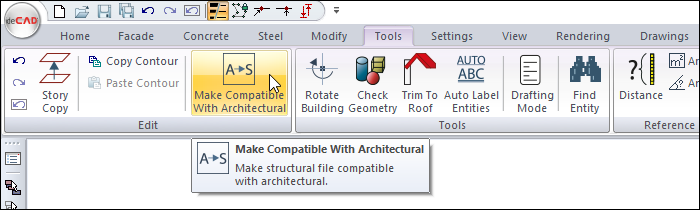

Make compatible with architecture command automatically arranges the layers of a project made with ideCAD Structural according to the ideCAD Architectural. The ideCAD automatically closes some open layers and automatically opens some layers.
  • After opening the project , click the Make Compatible With Architectural icon in the ribbon menu .
  • Except for the sketch and rigid diaphragm layers, all layers that concern the architectural are opened.

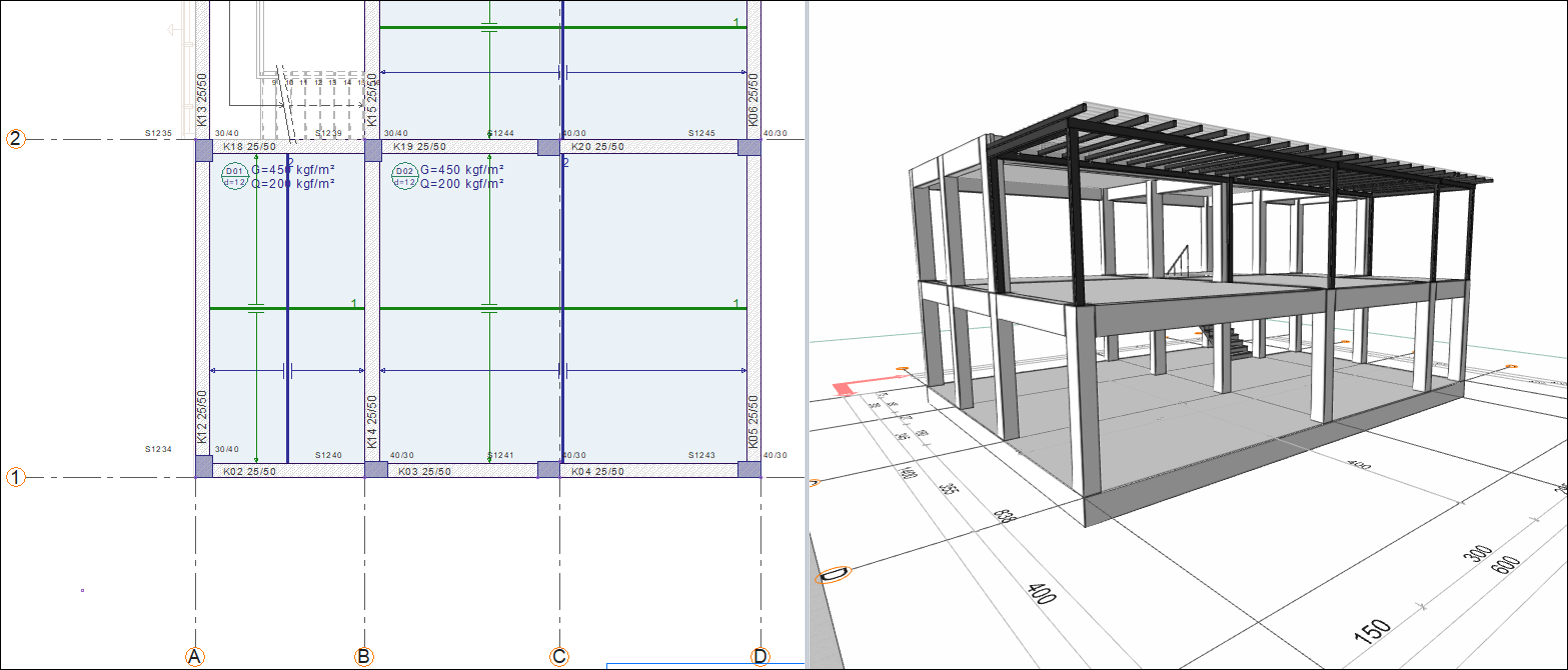

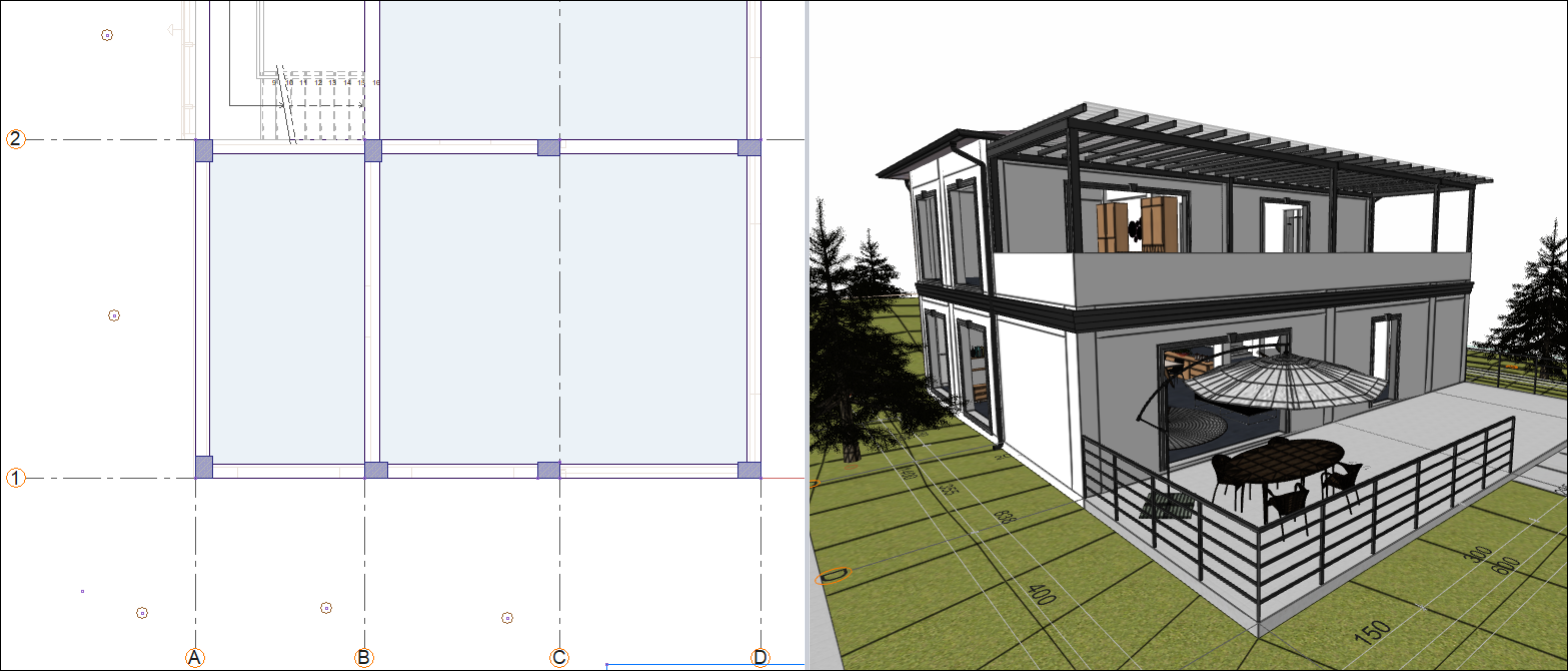

The table below shows the initial state of a project saved in the ideCAD Structural, when it was opened in the ideCAD Architectural, and its state after the architecture was applied.
Before make compatible with architecture
After make compatible with architecture

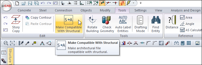

Make compatible with structural command automatically arranges the layers of a project made with ideCAD Architectural according to the ideCAD Structural. The ideCAD automatically closes some open layers and automatically opens some layers.
  • After opening the project , click the Make Compatible With Structural icon.
  • All layers concerning structural are opened.
The table below contains the layers that are closed in the layer settings dialog and the sub layers that are closed and opened in the drawing details tab.

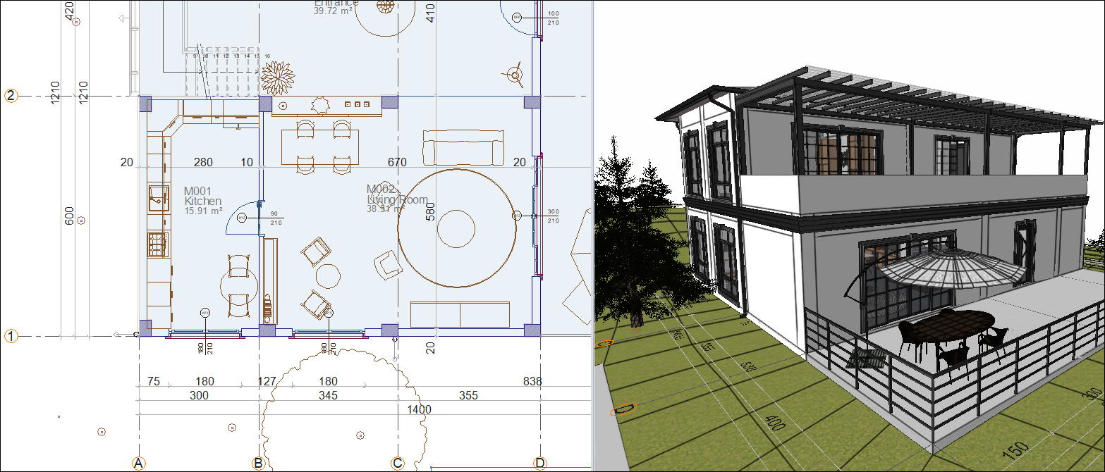

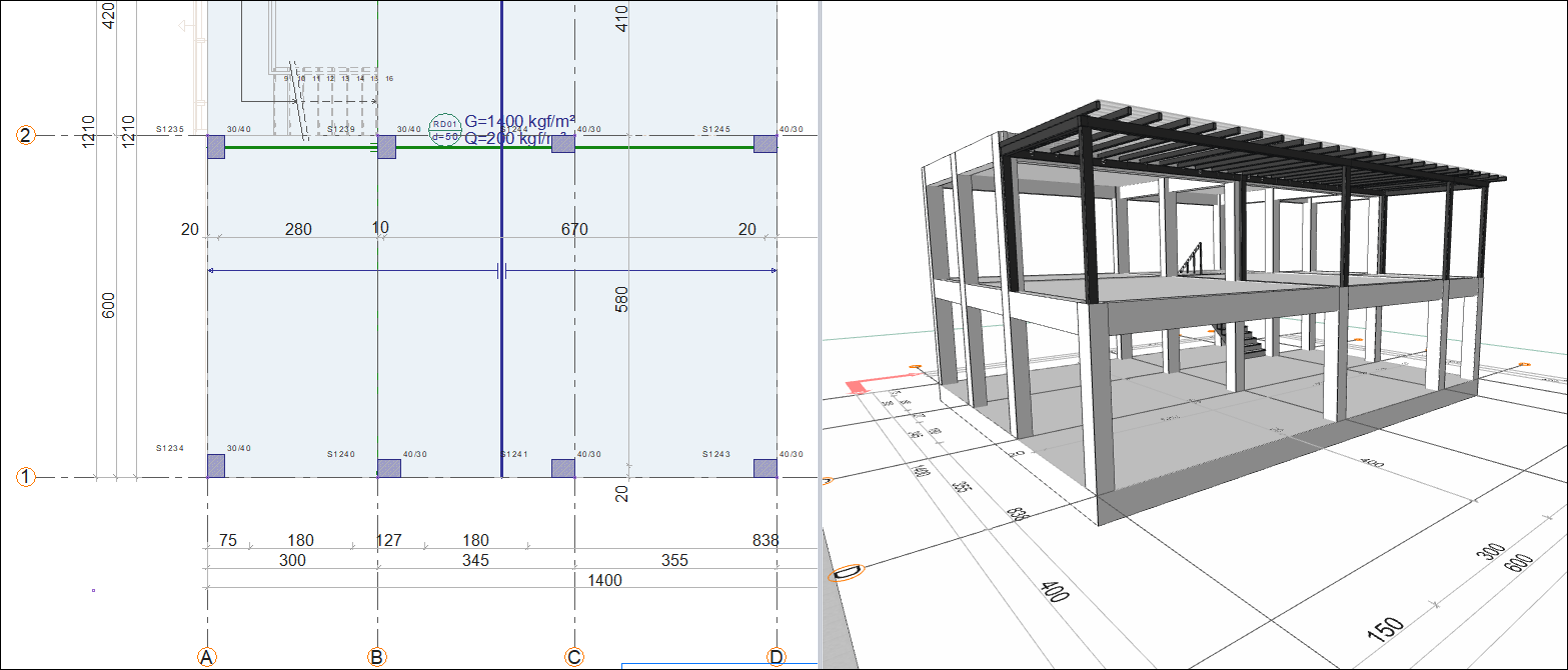

In the following table, the initial state of a project saved in the ideCAD Architectural when it was opened in the ideCAD Structural and the after the make compatible with structural was applied.
Before make compatible with structural
After make compatible with structural
