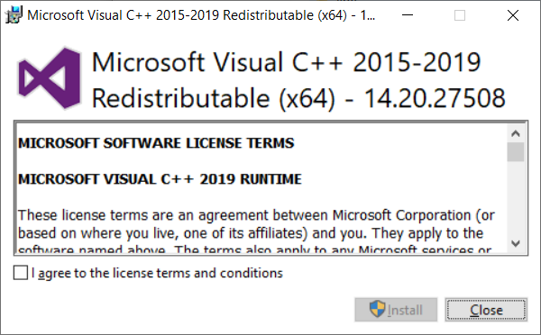

  • During the installation, the following screen will appear. Click Install to complete the installation.
  • After the installation process is completed, you can run the ideCAD program.
