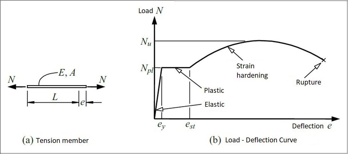

Design of Tension Members
  • Elements subjected to axial tensile force are simple elements in terms of design. Since they are under uniform axial tensile force, they act by the stress-strain curve obtained in tensile tests.

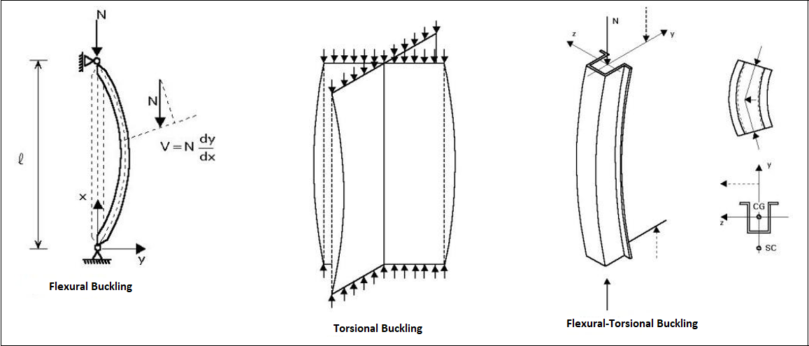

  • There are two main types of buckling, local and global buckling, for elements subjected to axial compression force.
  • Global buckling is divided into three categories: Flexural Buckling, Torsional Buckling, and Flexural Torsional Buckling. These types of buckling are also the limit states of members under compression.
